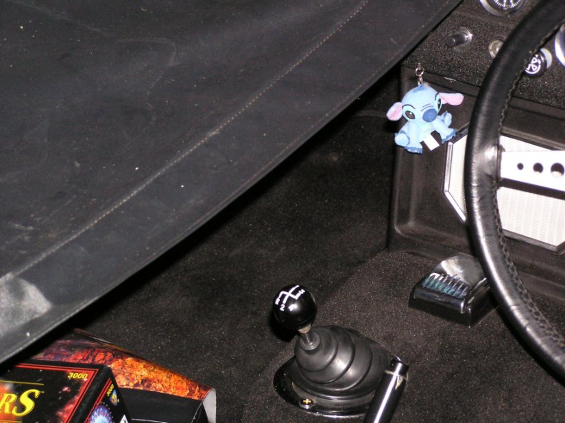

It's an easy mod my B has had it's gear lever considerably shorter than standard sice before I owned it (see attached photo).
I find it's like working with a side stick controller, the gear change is more a diagonal movement than an H pattern.
Reverse needs to be smacked into position though.
Compared with my C GT the gearbox in the B is quite easy to shift through and has a very light clutch, I certainly wouldn't do the mod on the C which has a much longer movement on the cltch and seems a bit heavier on the gears.
The length as shown in the photos is as short as I would recommend you go and is definitely more than the inch mentioned elsewhere.
