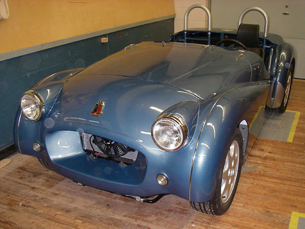

Sounds very interesting. There is a TR3 which has been widened featured in the British V8 Newsletter as well, stil not quite finished when the article was published. The major stumbling block is what to do for a windshield? Steve used a plexi racing screen, but the others look like they're planning on using a full frame and finding a curved glass to fit isn't going to be easy. https://www.britishv8.org/Articles/Triumph-TR3-Plus-4.htm
