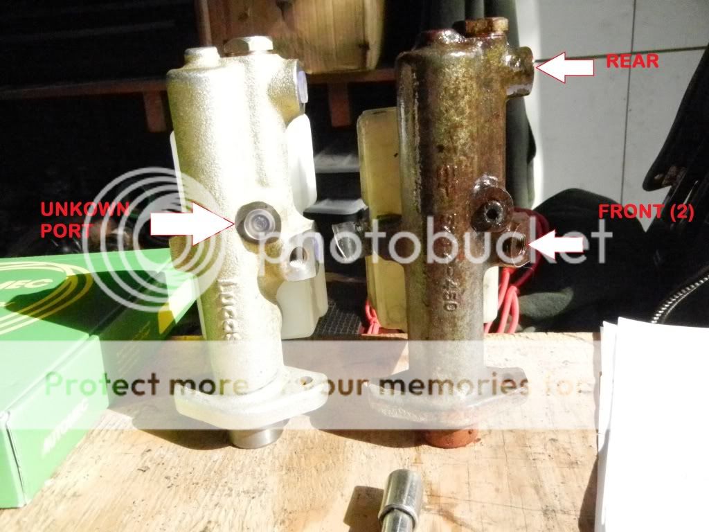

Replacing a b master today- and i notice a 4th port? on the bottom- the original has a rubber plug in it. The new one has no plug, but the port is there with the shipping cup in place.
What is this port all about? Can i just plug it like the original?

Ok - I guess this is a tuff question. Since the original was plugged- i will plug this new one and see what happens. Guess i am the first one to notice/question this. I am just curious as to why this extra port is there?

Can't imagine, Mark. Plug th' thing, do a driveway test before ya count on it.

Here is what i am asking about. the photo shows the two master cylinders. the one on the right is the old one and on the left the new one. the port directly on the bottom is my curiosity. That black bump on the bottom, on the right hand cylinder, is a rubber plug that looks like it has been there since before time began. The shipping plug is still in the one on the left. Holes are tapped, and there looks to be some kind of valve up inside there.

I believe that port on the bottom is where the brake pressure failure switch is located.
I plugged the port with a bolt and brass washer for my V8.

Ricks right the port is for the brake pressure failure switch and normally if the master cylinder is good they will not leak however if they go bad they leak and you need to replace the master cylinder. I think moss has a bad batch as there has been more than a few reports of them leaking and I recently got one that also leaked in short order.
