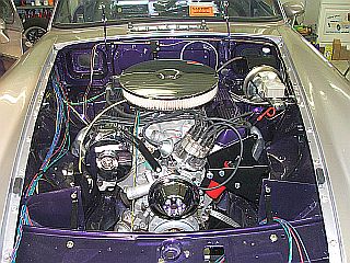

Yes...3.9 litre Rover. It's been bored and stroked (and is now cross-bolted as well.)
BW T5 transmission and an 8" Ford differential w/Auburn posi.
FastCars front suspension and Classic Conversions four-link rear suspension.

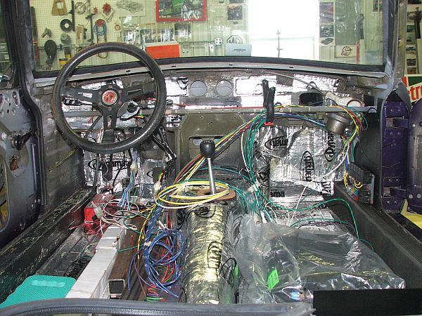

Here's the interior...new Dynamat installed and wiring to be run.

Yes, it is. The MSD 6AL box will be going high on the driver's side kick panel.
My a/c unit from Nostalgic Air arrived last week as well.

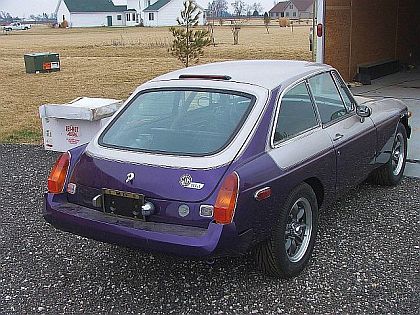

Rick, what's up with the colour? under hood and body both look freshly painted but not the same colours?
It is two tone, silver over purple.

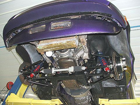

Here's the Fastcars front suspension...I'll be adding a 7/8" sway bar after the radiator and a/c are installed.

cool! that's really going to stand out at the show and on the street!

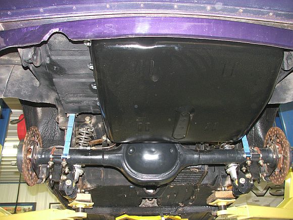

And the four-link rear suspension from Classic Conversions.
