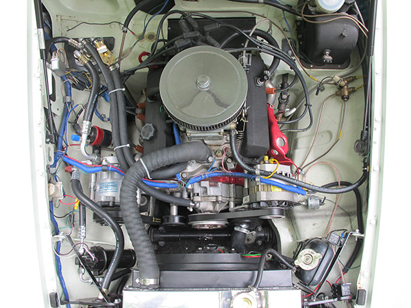

Meant to ask but always forgot; was it necessary to remove the Smith's heater box to fit the V-6? And if so, did you put a heater core in the footwell with the AC unit somehow?
It's not necessary, though it does afford more room for the dizzy. The AC unit I installed included a heater core in the evaporator housing under and behind the dash. A bit tight and fiddly on the installation due to all the hoses, but worked out very well. You can see the "manifold" for the heat and AC hoses upper left in this picture:
Now I see the heater control valve. Shoulda noticed it in the photos in the link. DUH!
Thankyou Mickey that's a great idea and will pass on.
You're welcome, and I'm happy to share any info if he has any questions.
At our age we do have a bit of slippage, don't we? :smirk:

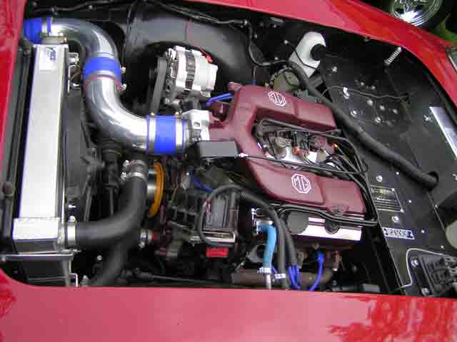

If you want you can make a GM V6 look quite at home in an MG. This is the 3.4 in my rebodied MGA.
That is a fine looking install.
Grats
