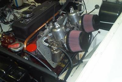

Here's a picture of my 67 with crankcase breather installed
