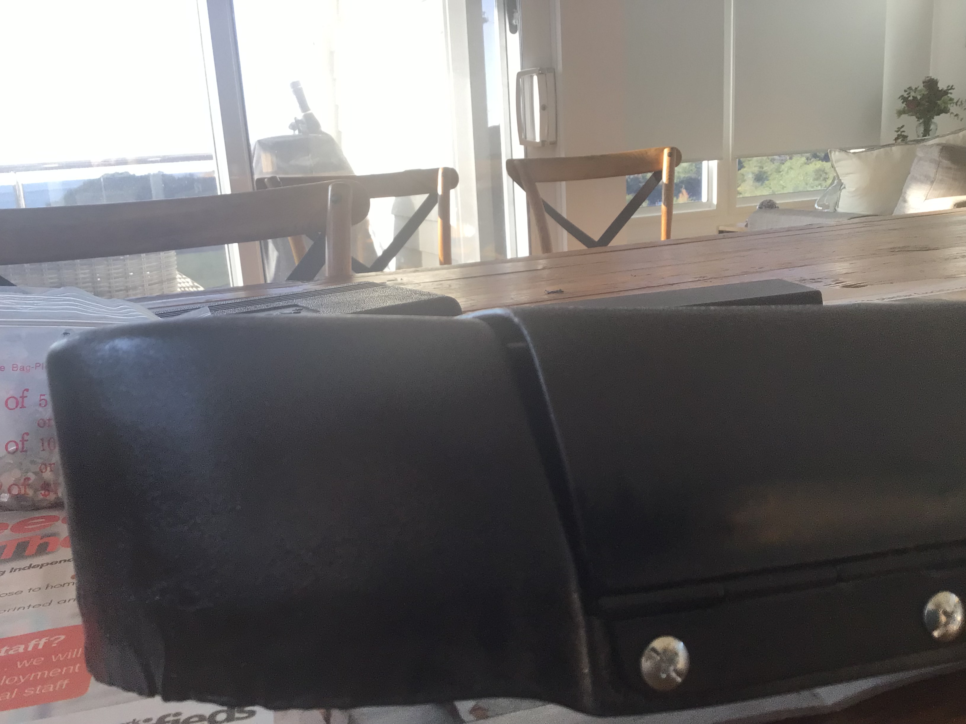

Yet another question from the newbie I have repainted the dash and all has come up well, when placing the glove box door into the dash
I have a gap of two mm on the sides but 7 mm at the top what I seem to notice from photos I have scene it seems to be fairly even all the way round
Any ideas how I could correct this or do I live with it ?

Can't be quite sure just seeing the photo, but some "gentle persuasion" using wood and a press. Pushing down VERY slowly on the curve of the door (distributing load evenly across the high point), to open up the angle slightly. Like pressing on an inverted "V" shape. Constantly refitting to see if result was a tighter fit to the opening.

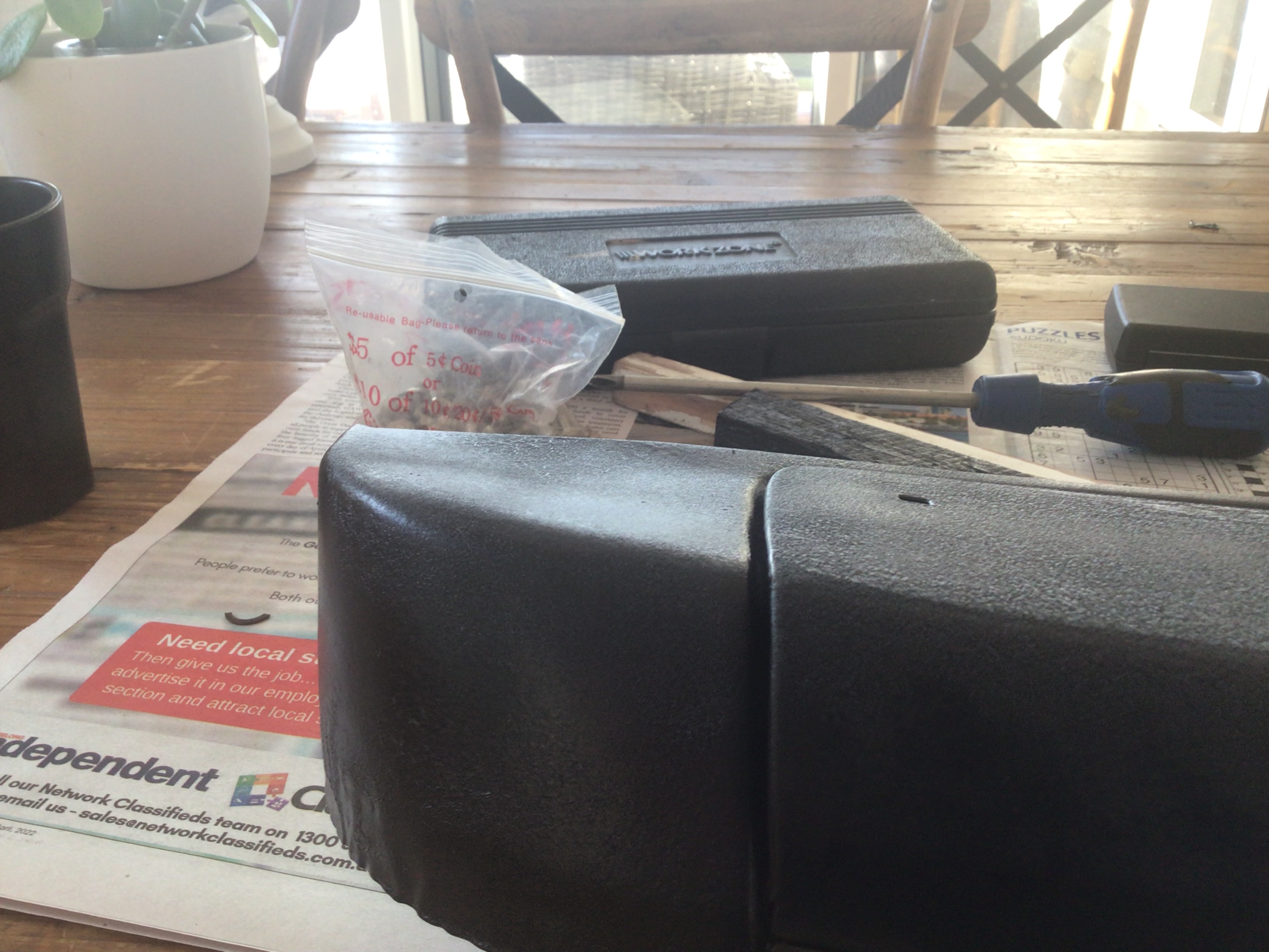

Do you think the using two sash clamps and timber would work. By placing the door in the dash and compressing the
frame by hand I can achieve a better gap fit. The bottom part of the dash frame seems to have some deformation in it and does not seem to be quite true I shall take photos I what I mean and show you

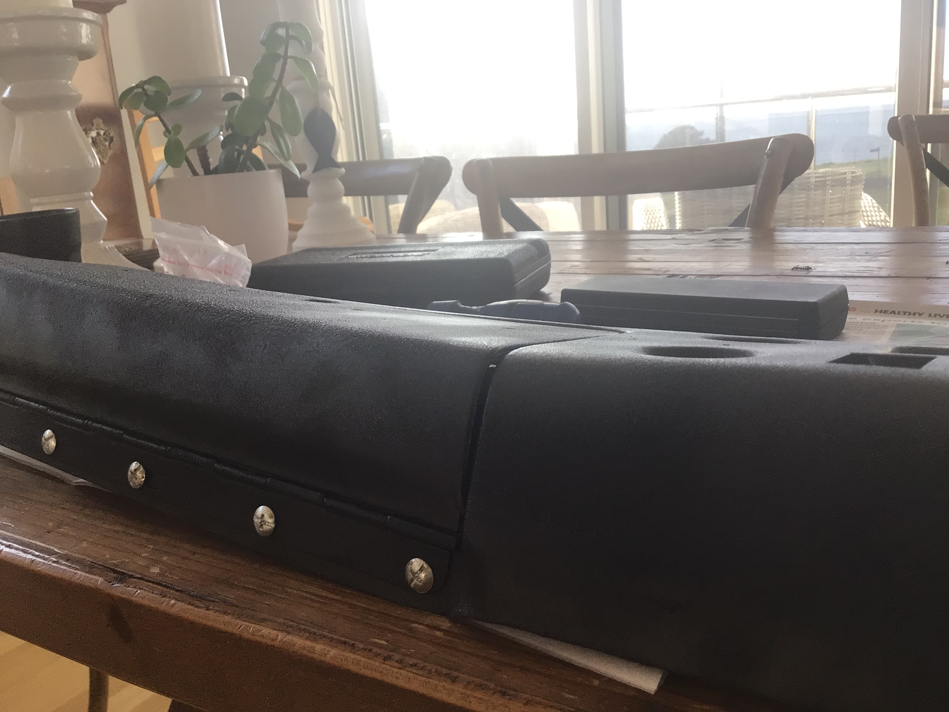

I was thinking about what you said so sitting at the table looking at the dash I bolted the glove box door back into the frame
see how the inner edge of the door is flush with the frame but the outer edge stands up and out
by twisting the frame glove box end I can achieve flush fit and much better gap at the top of the door With the dash.

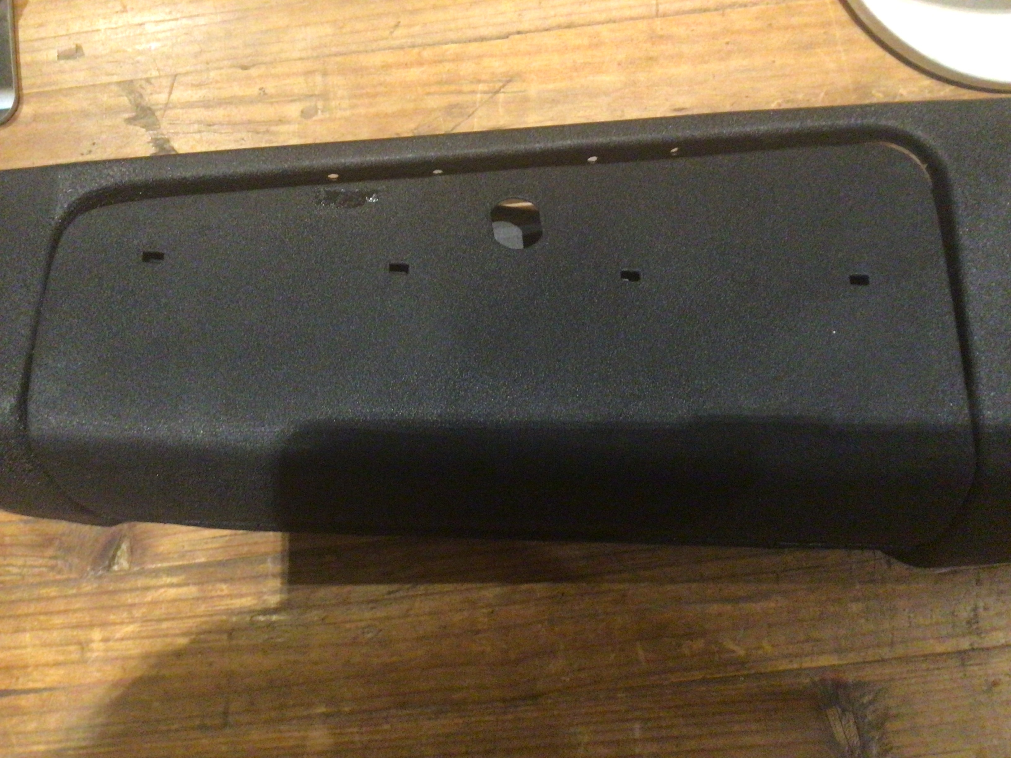

I noticed that the end of the dash face glove box end is not flat but slightly dished I am wondering if the car has been in an accident and repaired as on the same side the front guard gap alignment was out so I had coerce it back.

Appears you've sussed it. The dash is normally flat all the way across. Even if you persuade the dash to comply, it may be that the front cowl is distorted and will twist the dash back into a curve. Only way to find out is to fit it.
As for the minister, you're likely better off with a strategic withdrawal. Live to mutiny another day.
You may also find the door needs persuasion after fitting the dash, and p'raps "cheating" the curve at the cowl with thin strips of aluminum or other material would be in order?
