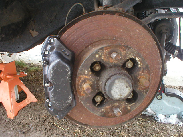

Jack,
I have yet to run them, I graduated college and lost my access to a machine shop at the same time. As soon as find a good shop here in Sactown, I will see if I can get the rotor adapters finished up. The prototype fits the front suspension great with a couple of spacer washers, so the revised design is a little thicker. They clear rostyle wheels and my V8 wheels, don't know about wires though. Check the attachment on this post to see the caliper fitted to my front suspension.
