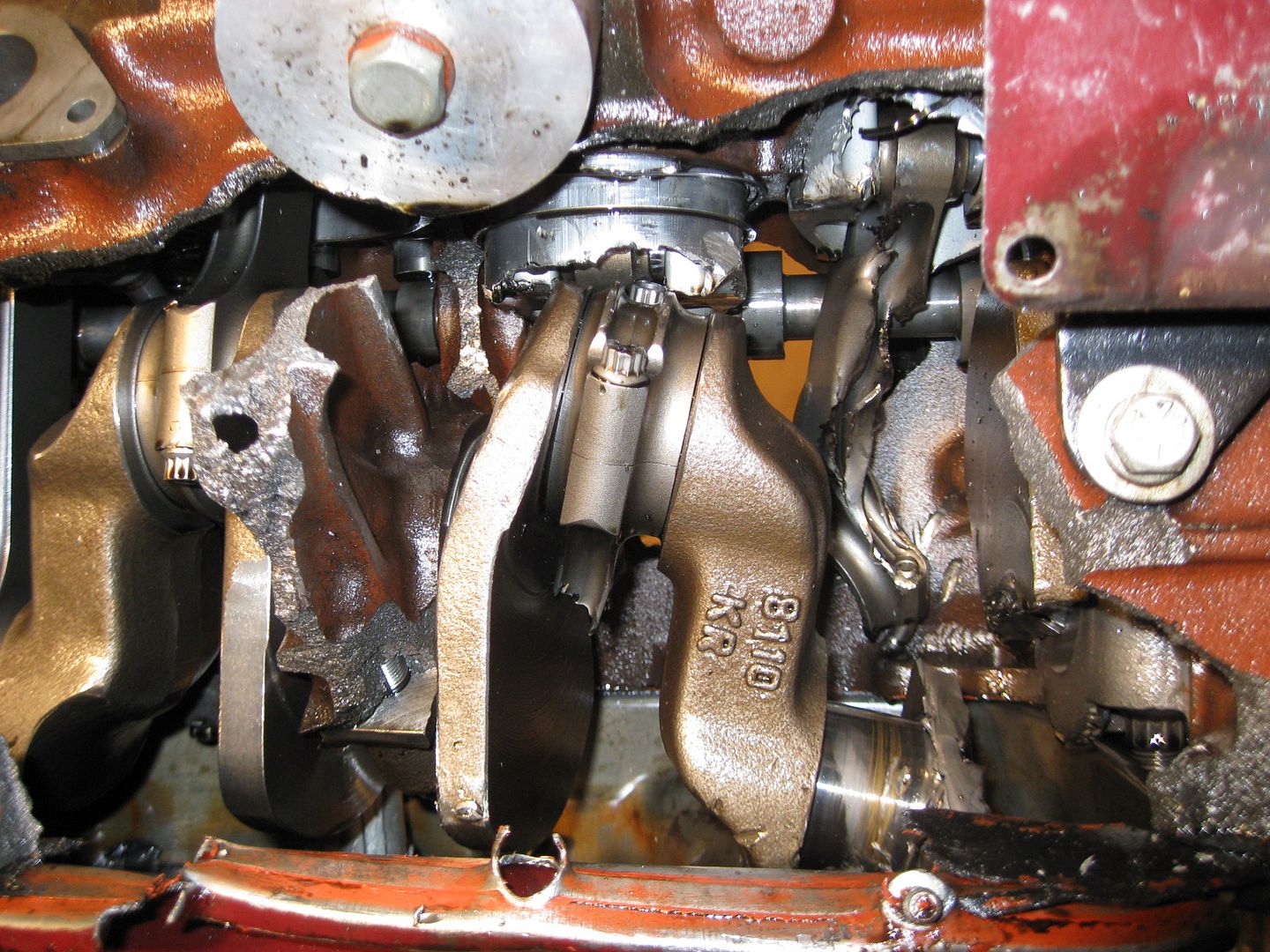

I thought I'd let you see some more detailed results of catastrophic failure on a 1600 cc BMC "B" series engine. This engine was in my friend John's vintage racer MGA. I posted a note about it before, but these are much better photos.
The link below shows photos of the post-mortem.
https://vintageracer.tripod.com/mga-engine.html
You may recall that I actually caught the engine failure on camera (he had just passed me when it failed). If not, you may want to you click on the video link (below), and slide to about 1:20 and watch, you'll see it.....followed by a view from his in-car camera of the same failure.
https://www.youtube.com/watch?v=gBFWSNiRVc8
John description of the damage:
"The centre main is still attached to the crank but no longer to the engine. Part of the torque reaction of the sudden stoppage was absorbed by the bell housing which reacted by cracking all the way around!"
Sample photo:
Full blown NASTY, that.

Been there, done that, never used that weak crankshaft again. The 1622 is much better.
Nial, What Rs was he turning when that happened? PJ
Paul: He told me he was keeping things at 6500 or under. The engine has at least 20 weekends on it, so it may have been a combo of loose bearings and general wear-and-tear.
Bill: This car is supposed to be an early MGA 1600 (but it has 4-wheel disks :shocked: ).
I think it's probably the 1588 motor. I was not aware that 1622 (Mk II) crank was better; that's good to know. I owned a 1500 MGA ages ago, but I'm more of an A series guy these days.

The 1500 and 1600 shared the same (weak) crank, while the 1622 was a different stronger crank. The 3 main MGB is the most durable 3 main of all with the sole exception of the Twin Cam, which was built to turn 7000 RPM in stock form.
