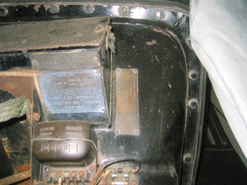

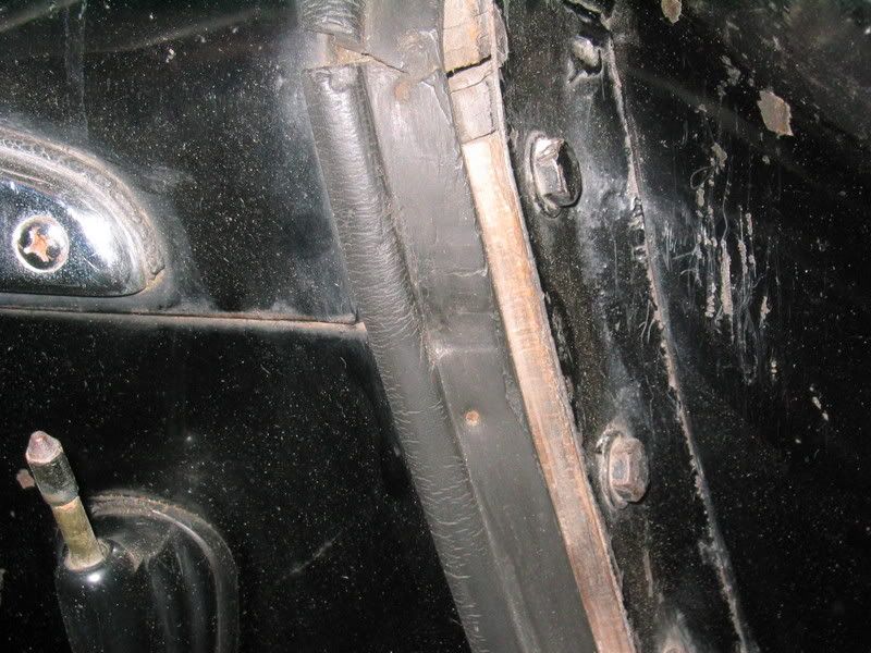

In the photo below, is that gap in the weatherstripping on both sides? &, if so, how wide is the gap? & wonder why its there?
Also, does the weatherstripping stop at the fenders or does it go underneath their edges?
It wraps the wood from bottom of each left & right side of the wood member on the bulkhead. It is head in plate with small flat head nails about every 5" or so.
Gotcha, thanks again!
There should be no gap in the bonnet pad. Yours is probably old and broken.
