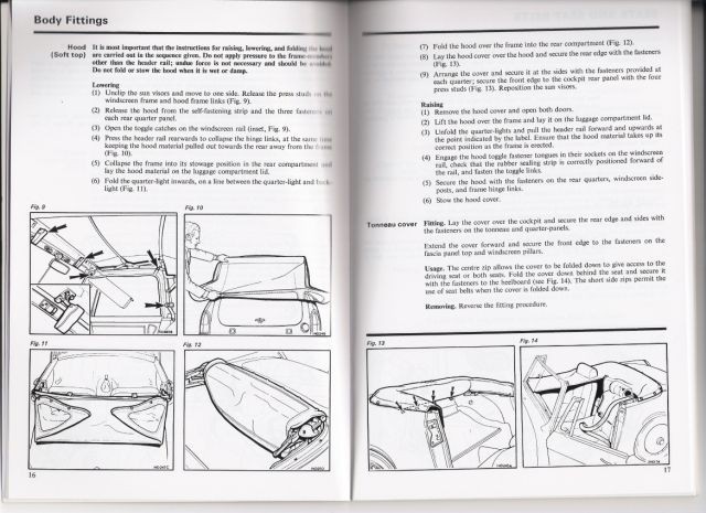

Here is a scan of the page describing top storage from my owners manual. It pretty much shows the way I have been doing it. Wondering now if I shouldn't glue some felt or something to the top frame where the top seems to rub???

Try this picture instead...lol. Attached the thumbnail instead of the real pic in the above post.

Yes felt belongs there on the orginial. My new one had it anyway. I did glue some black felt on the top bows of the one I restored.
