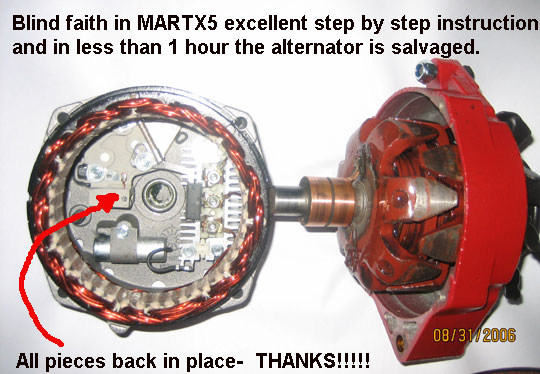

Martx- I pulled the new alternator out of the trash bin
and attempted to follow your details instructions
on how to salvage it. Promised you a photo if your
technique worked. It did, photo attached.
And here is the photo process of how to change out a
Lucas alternator for a GM unit. I know the TR experts
on the internet have fancy web pages on changing out
alternators but I'm just a know nothing hack so if I
can manage it, anyone can.
https://community.webshots.com/user/DTBanks
Thanks to everyone who offered me suggestions on how
to go about this process.
dale

I was surprised to see you took the alternator apart! I can see why you did (to paint it... right?) and am glad you got it back together, though!
Next time, might I suggest to just use masking tape? First use it to close up all the holes during the grinding and cutting on the lower mounting lug of the alternator (best keep the grinding dust and metal debris out of the alternator!). Then use it to mask things off while painting! I think that might be easier, unless you really, really want to see what's inside an alternator... and fiddle with the reassembly! /ubbthreads/images/graemlins/wink.gif
The suggestions you got for reassembly were good. BTW, instead of paper clips or wire to temporarily hold the brushes back during assembly, I've occasionally found plastic zip ties or even a strong piece of thread useful. Once it's assembled, snip the zip tie or thread and just pull it out of the way to let the brushes spring back into place. These are just a couple alternatives that might help in one case or another.

Now that you have modified the alternator to fit the car, I suggest if it ever needs it that you have it rebuilt, rather than exhanging it for another (which is what most auto parts stores will want to do). Usually one can find a local auto electrical shop that does alternator (and generator, perhaps even starter) rebuilds, particularly on a really common unit like the Delco 7127. By having this particular unit rebuilt, if and when it's ever needed, you can avoid having to "customize" another one before it can be fitted. Generally the cost of a rebuild is about the same as an exchange.

Re: Alternator conversion
Hey Alan,
Nope, I didn't take it apart to paint it. I took
it apart out of total and complete ignorance as
to what I was doing. I didn't have a clue and that's
the truth.
I kinda figured it would be bad to have all those
metal grindings inside the alternator. So I thought
I was simply taking off the cover. SPROING!!!!
Out popped the innards!
I used a length of bright orange, thick, heavy duty
extension cord to loop around everything to find the
even plane.
I put a coating of that cooked on red plastic powder
just for the fun of it. It looks much better than the
photo.
