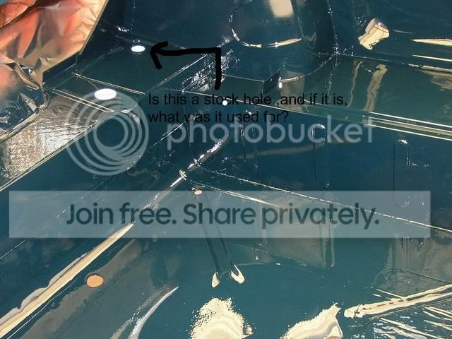

Finally, Twp part epoxy and two coats single stage urethane in boot.
Click to enlarge
Ok 1 Question
I have no idea what the hole was originally intended to service it was plugged. There is one just like it on the other side.

I'm only guessing, but did that hole have anything to do with the fuel line on pi cars?
i WAS KINDA GUESSING THAT TOO.
