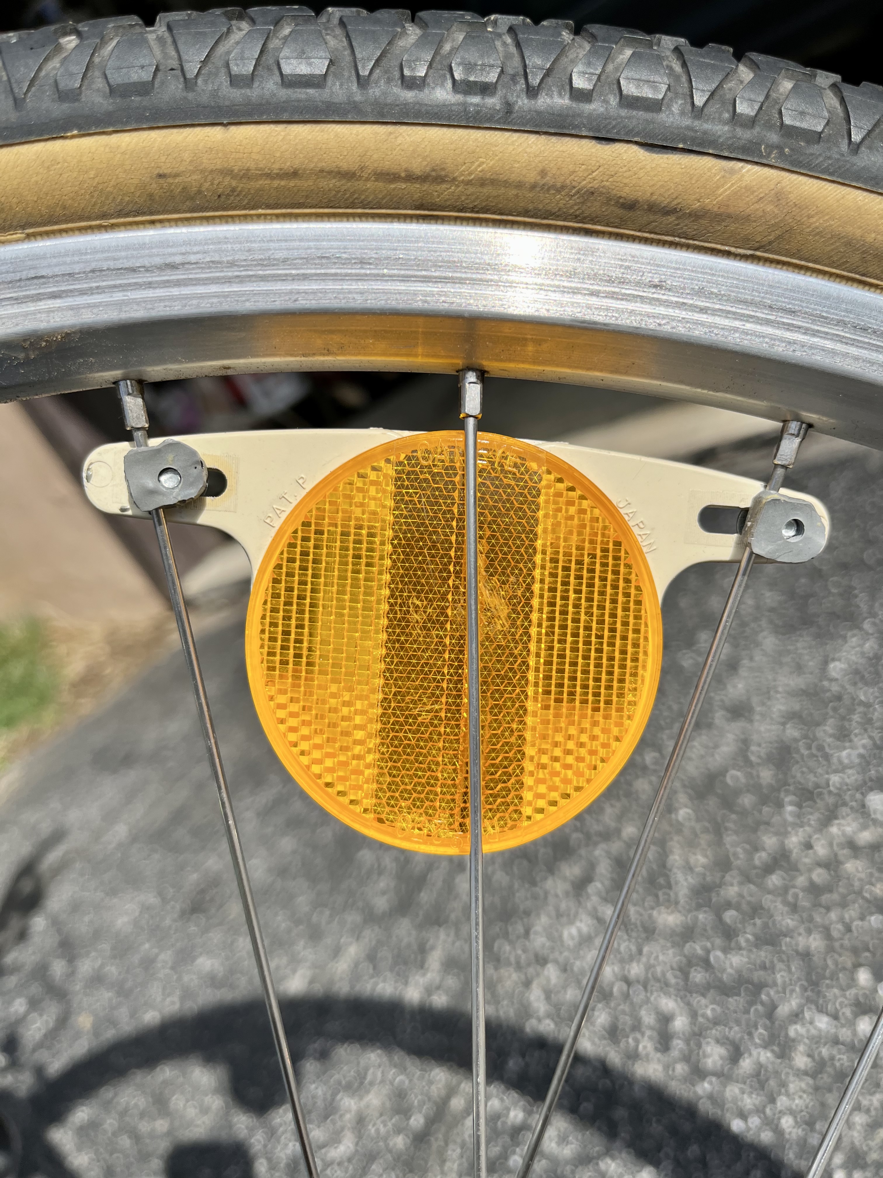

Had a couple of small clamps that hold the reflector on my bicycle wheel break. My bike is over 40 years old and the small plastic clamp is brittle and it broke about a month ago.

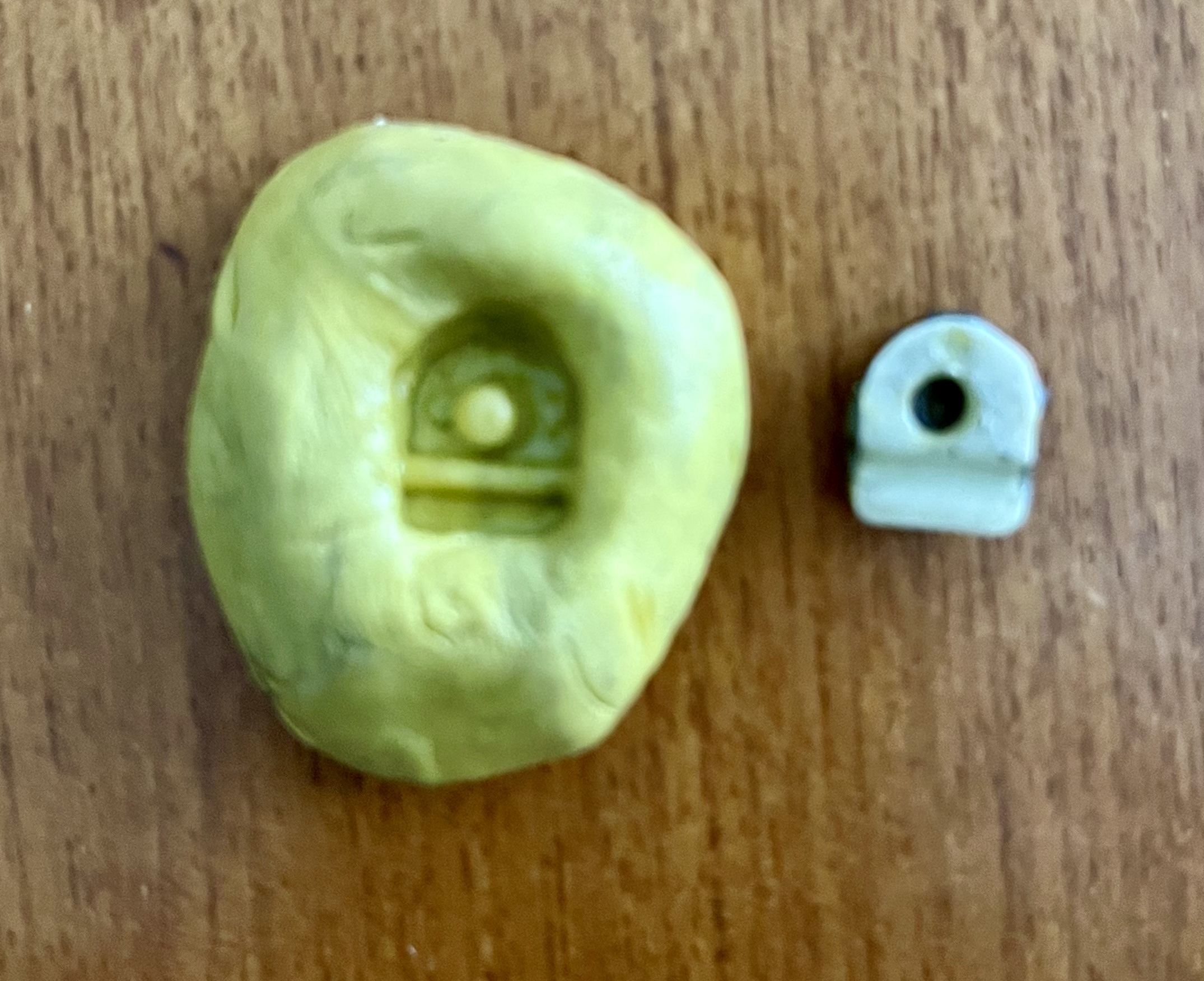

Took the only good one I had and made a clay mold then filled it with epoxy.

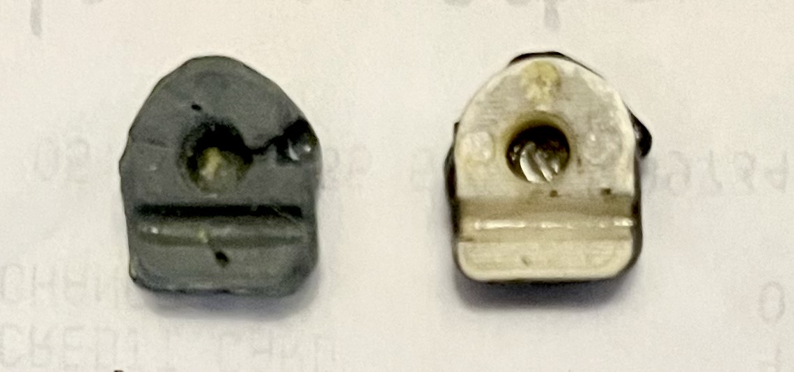

The white one is the original and the grey one is the copy. Going to make two more.
