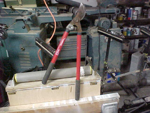

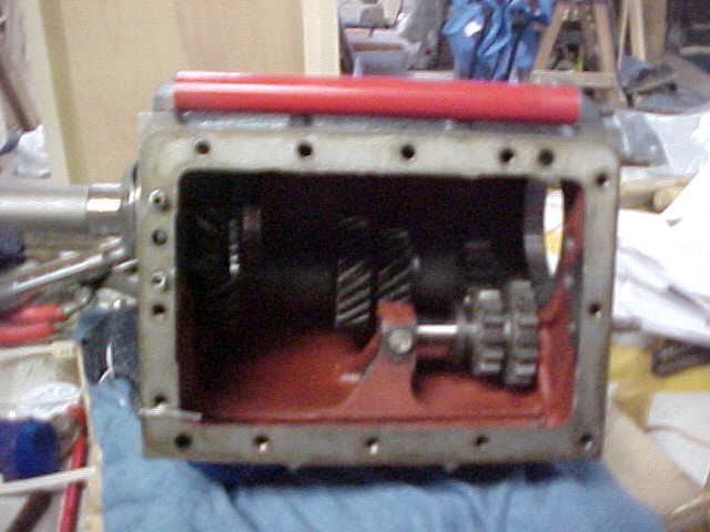

most of you know i love making tools anything i can come up with to make a job easier if i need one that is unavailable or too expensive for a one off shot at a job or even if i dont appreciate the way a standard tool performs ill make my own, well heres one i made up for rebuilding my trans. i left my healey work manual with the guy that was rebuilding my engine didnt think id need it because i took so many pictures when i disassembled it, so i did come up with this on my own, however im no longer able to reach as high in the bushes with my pruning sheers. ah it was conceived late sunday afternoon. 23/32" = .718 dia. x 7.5" long. i call it "the austin healey 3000 transmission case temporary layshaft pre-loading tool" for short. its used to pre-load the layshaft with all the needle bearings spacers etc. once you place the layshaft with the "tool" through its center in the case and align it at both ends you just slide the layshaft into one end of the case and through the assembly the "tool" simply slides out the other end leaving the layshaft and all the bits in place. it worked perfectly first shot.

I have a broom handle that is the exact diameter. It is now a bit shorter than original. It's technically called a dummy shaft. The only way to go when assembling a gear box.
