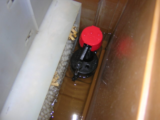

I run a guitar repair shop. In any stringed instrument shop, humidity control is <span style="font-style: italic">CRUCIAL.</span> During the winter in my area, humidity can drop into the single digits, which could spell disaster for my customers' wooden instruments. For the last 18 years, during the snow season, I have been enslaved to the daily -- sometimes, twice daily -- filling of two console humidifiers with 20 - 40 gallons of water/day. Every day. If I don't do it, somebody else has to. There is no holiday.
FINALLY, I got smart!

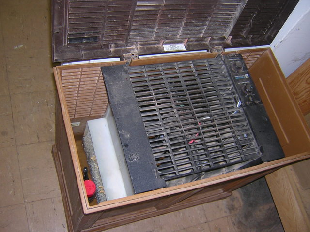

Pic #1 is just a set-up shot of one of my rigs.
Pic #2 shows the Fluidmaster 400 toilet tank fill valve which is now employed to maintain the proper water level inside the beast, 24/7/365, AUTOMATICALLY.
I'M FREE!!!!!!!!!
FREEEEEE!!!!!!!!!!!!!!
FREEEEEEEEEEE!!!!!!!!!!!!!!!!!!!!!!!!
(I just fired 'em up yesterday...)

It's even CHEAP! The plumbing was done with 3/8" OD PVC "refrigerator ice maker" tubing, a couple of cheap compression fittings and the fill valve can be found at the hardware store for five or six bucks. If I hadn't had to run 80 feet to get to the water, the whole project would have been $40 or $50 for both tanks.
