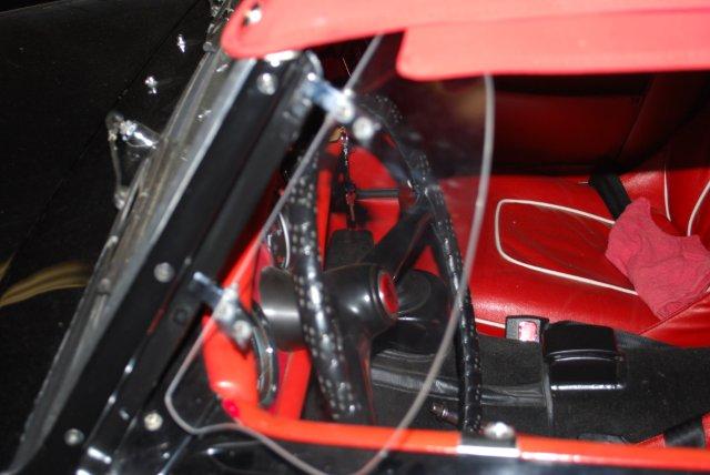

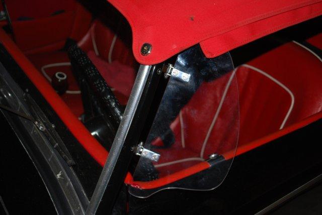

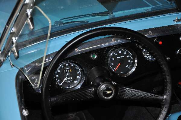

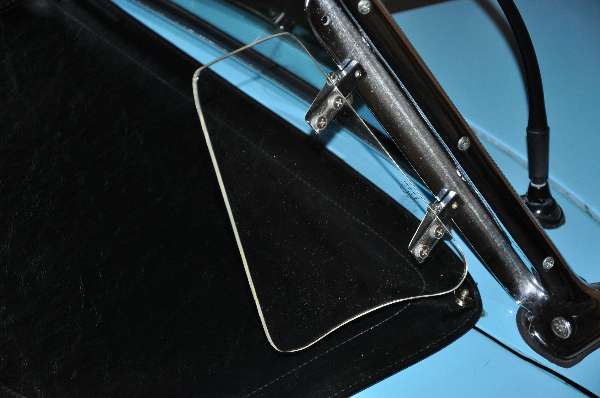

Miss Agathas are just like yours David. Yep completely adjustable, in fact can even be removed and replaced all you wish for shows or what ever.
These are one of the best accessories. You have to have the correct brackets/hinges though that clamp to the back edge of the upright like that.. I know the Spridget and A use the same type, but I don't know what else does.
They are made to even allow for side curtain installation in an emergency. The main difference between the Spridget wind wings and other cars, is the fact that there is the curved stepped up area cut into the bottom of the plexiglass to allow the door to open. If it wasn't there, where the door meets the top of the dash will not clear when they are pulled in.
