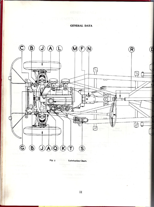

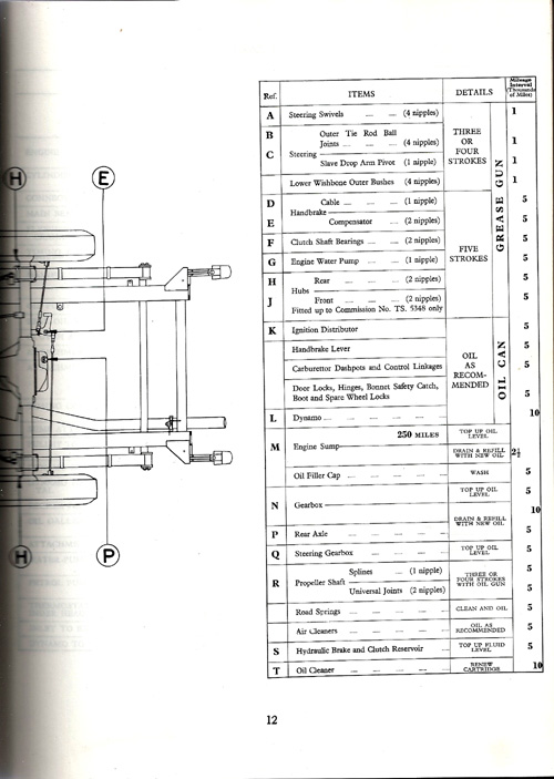

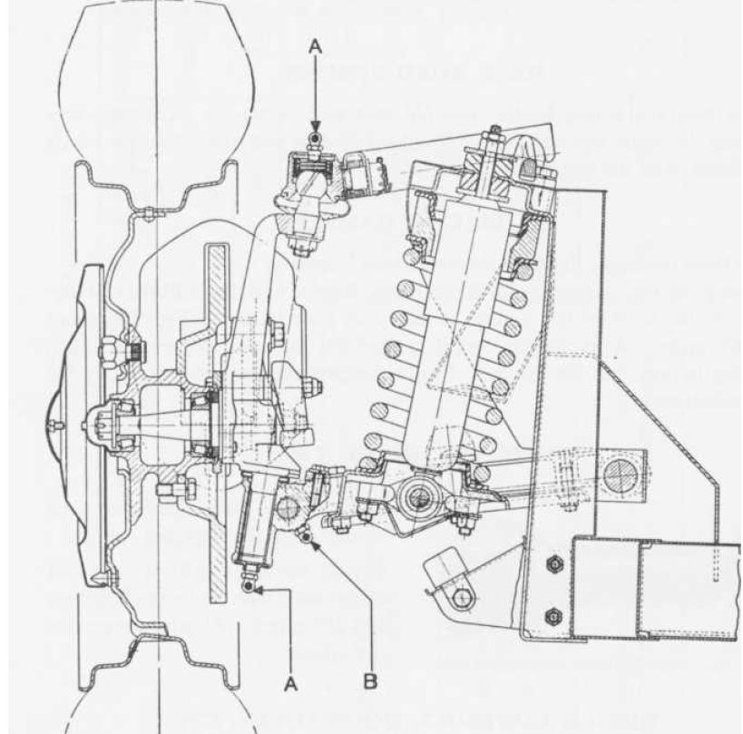

As they say, a picture is worth a thousand words. Your photos are a huge help in finding and identifying the grease nipples.
One of the problems I am discovering is that each manual -- including the Moss catalog -- uses slightly different terminology for these suspension elements. Your key, above (the akas) are a great help.
Practical Hints suggest three or four strokes of grease every 1000 miles; Haynes suggests the same every 1,500 (where I am today with my car); and others suggest as much as 4000 to 5000 miles. I think I will go with a couple of pumps every 1,500 miles. If I don't overdo it, it couldn't hurt.
