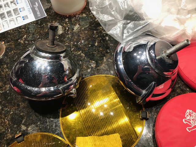

I dug out a pair of SL576 amber fog lights. one is NOS and one is lightly used. I haven't decided whether to install them or stow them for future consideration but my question is how do these attach?
Mine have just the threaded pipe out the back. Is some part missing that I may still find in the boxes or are they flush mount on the grill?

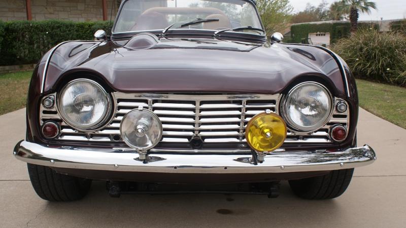

Because of the depth of the Lucas 576 light, there is not an easy way to mount them without interfering with the bonnet. Most people use a light mounting bar that put the lights ahead of the bumper. I purchased my fog light bar from Revington TR in the UK.
The amber 576 fog lights are becoming pretty scarce. They are commanding some pretty good prices on the market.

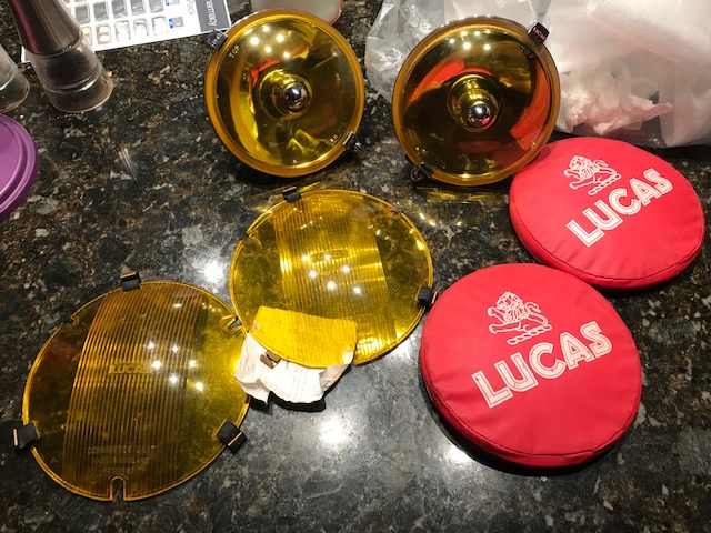

Just new to the forum so learning the ropes. Had to reduce resolution on photos to upload. But here's the fog lights, covers and yellow covers for regular lights also.

They appear to be the type like Jag Mk IIs had on them that go through the body to mount. I don't know how to go about putting them on a TR4. Maybe a mount like the one in my picture and a 90 degree angle bracket.

FYI: Those are actually amber DRIVING LAMPS; fog lamps would have the "fluted" lenses. ISTR being told that amber driving lamps were common in Canada? But yes, those particular versions are quite rare these days!
