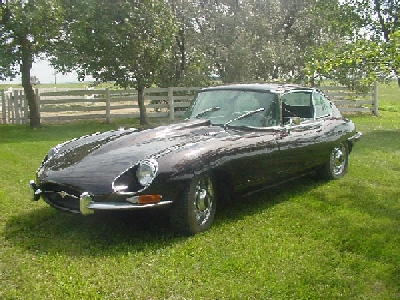

Another one bites the dust....installed high performance aluminum water pump...went ahead and put thermostat back in since it's getting to FALL...seems to be behaving itself.
Now on to the electrics...nothing works cept ignition. No headlights, no sidelights, no tail lights, no panel lights. no interior lights, no gas gauge, no tach, no speedometer....Ayeiiiiyi!!! where to begin!
PS: I added a pic of the PURPLE PASSION!
