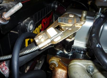

Thanks to BobbyD's website, I replaced my original heater valve with the one shown. I have no regrets as it works MUCH BETTER. It is smooth to operate and controls the hot water flow more evenly. I went one step further and removed the small detent ball in the neck of the heater control cable. Now there are no "stops" and I have infinite control.
See BobbyD's site.

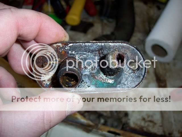

This could be part of your problem as well.....
That is what my bulkhead heater hose connection looked like when I did my resto three years ago.

Darrell_Walker said:
Here is the link to BobbyD's page:
https://tr6.danielsonfamily.org/HeaterValve.htm
Looks like a good solution, but I haven't yet found anyplace listing the valve, except for one Scout site that has them for $100.
I bought mine last year and paid $34... keep looking you will find one for a lot less than $100.
Have you tried your FLAPS?
ISTR, Ford F-150 of the the mid 60's had a similar valve. In-line and cable controlled.
That alternative valve looks like the AMC style item that can be used as a replacement.
While it is smoother in operation than the Brit item, it has its own quirks and has been known to shear off if over stressed.
