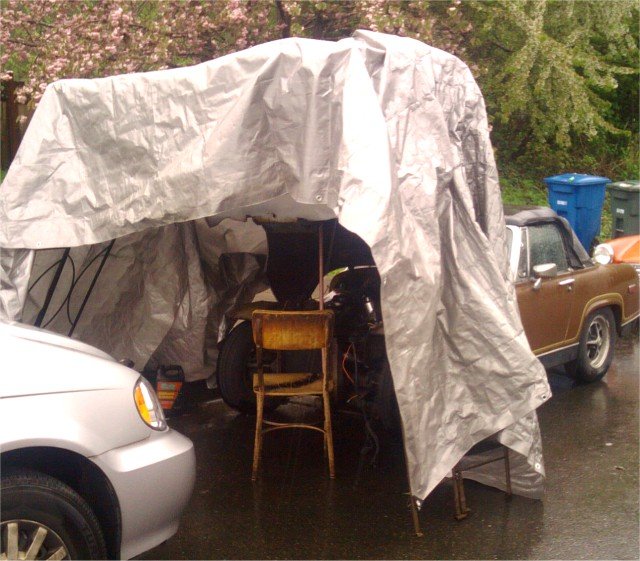

Now if it would stop raining long enough to get the thing put together.
I put the little beehive turn signals on, that helps.
Haven't started wiring yet, haven't finished mounting the new radiator yet, haven't installed the light buckets yet.
