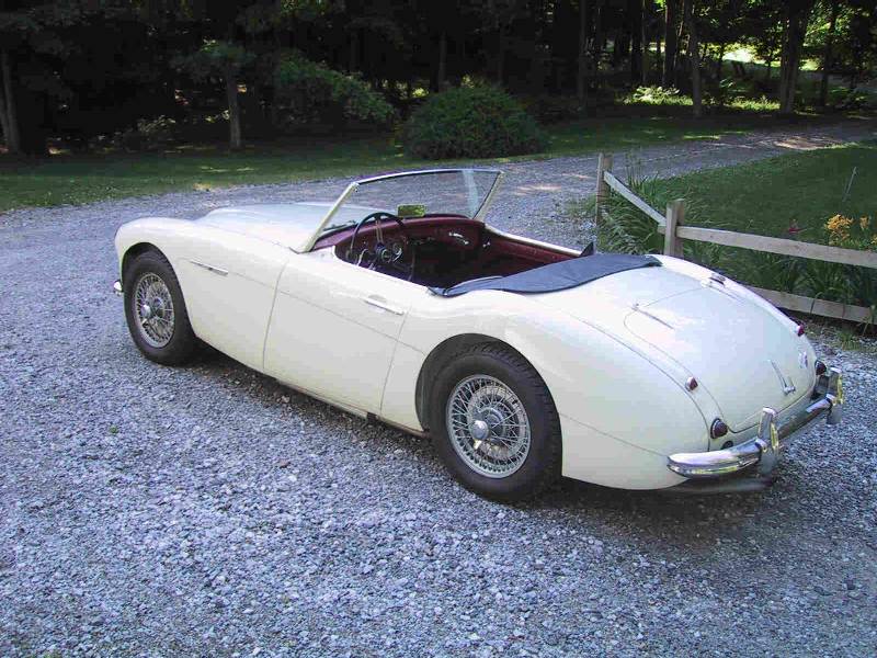

Thanks Keoke...the 11/16 socket doesn't quite fit on the nut, I'll try a metric size (18 mm), and a stubby screw driver. Nothing is easy...except looking at my beautiful car. See attached.
