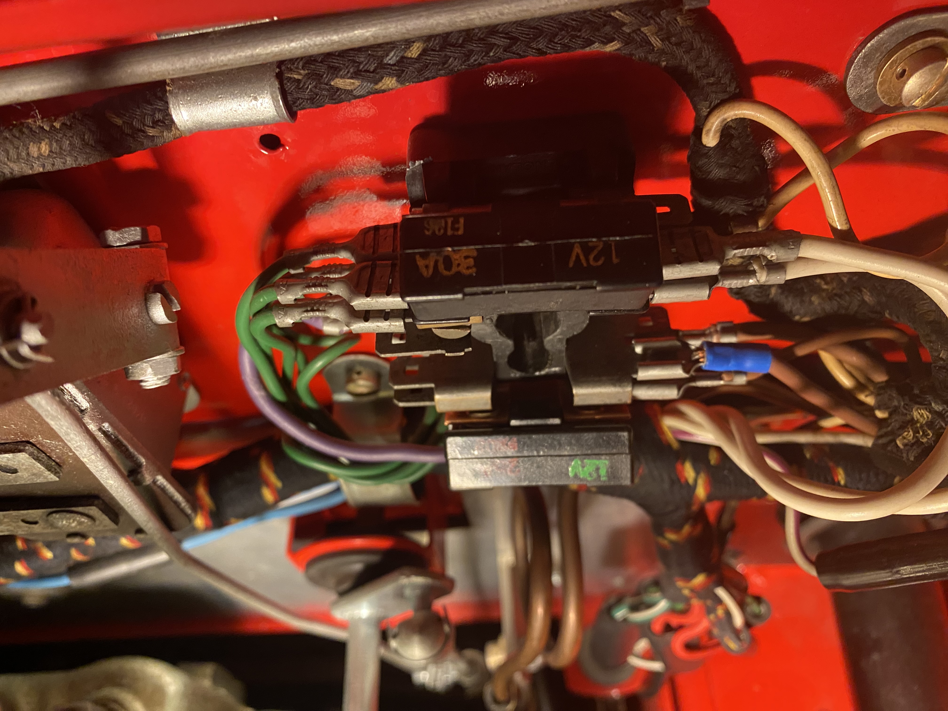

These two fuses top and bottom are popping out of their holder too easily. Just took ownership of the car and not sure if they’re fuses or relays. Any ideas on how to keep them in place? Ed

From the markings they appear to be fuses. But they're not original. Should be round glass tube style. I'm curious to see what these are. Wonder if they reset.
I've never seen anything like them; a '4-pack' of fuses? Curious that they're rated 12V; usually, you want a higher rating than the circuit.

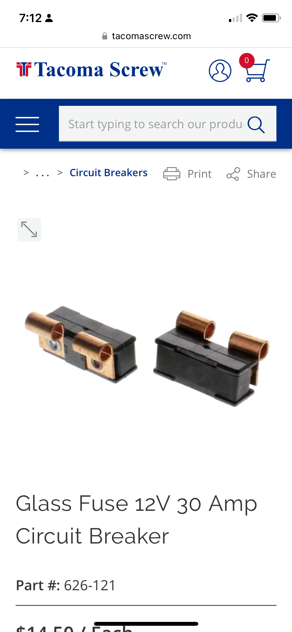

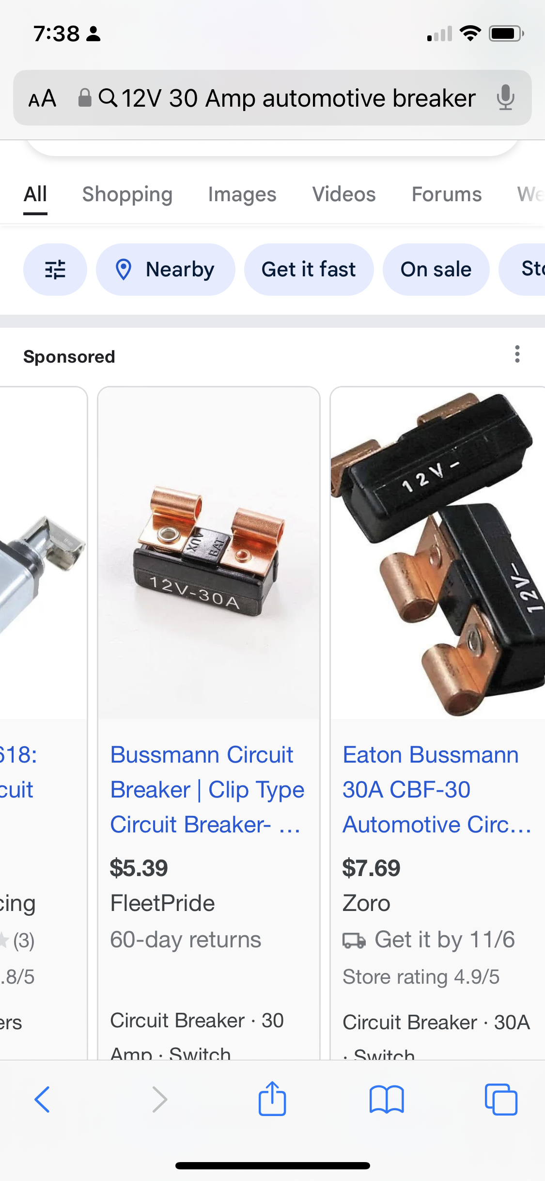

So they are not fuses , they are circuit breakers . I would just get the correct fuses for the holder and replace them . Make sure you carry spare fuses . There are holes in the holder for spares .

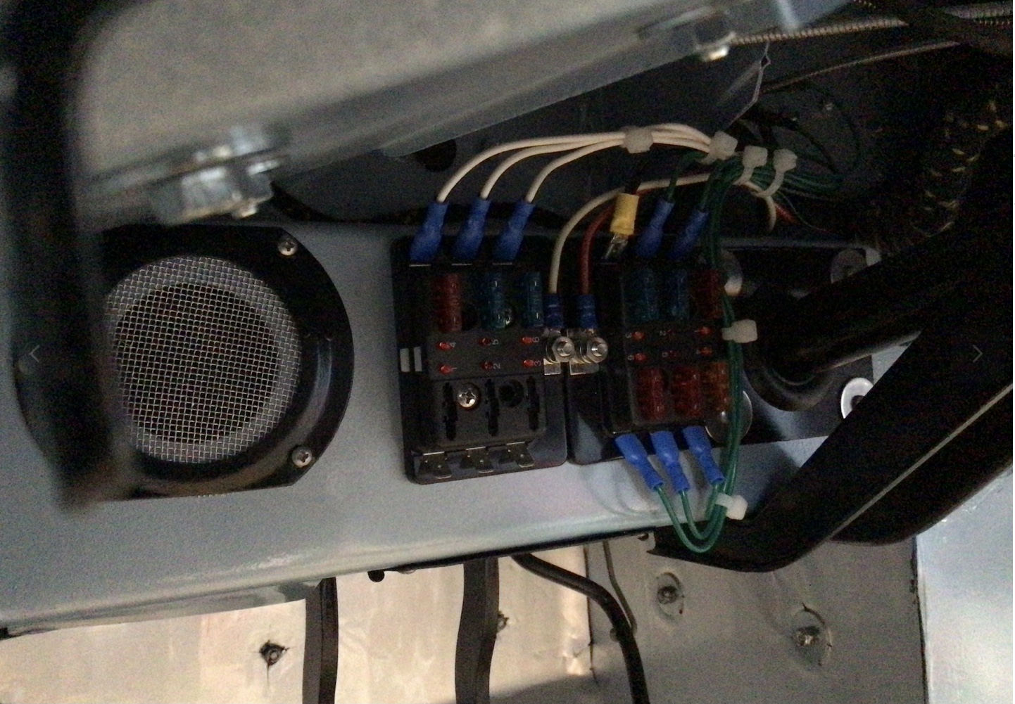

Alternatively you can do some simple rewiring and separate all the loads into individual circuits and have separate fuses . Makes troubleshooting a lot easier and better protects your wiring harness .
. Also be sure to add an inline fuse holder for the rear licence plate lamp in the trunk . If you get rear ended and the wiring shorts out the whole wiring harness will have a meltdown and take the car with it .

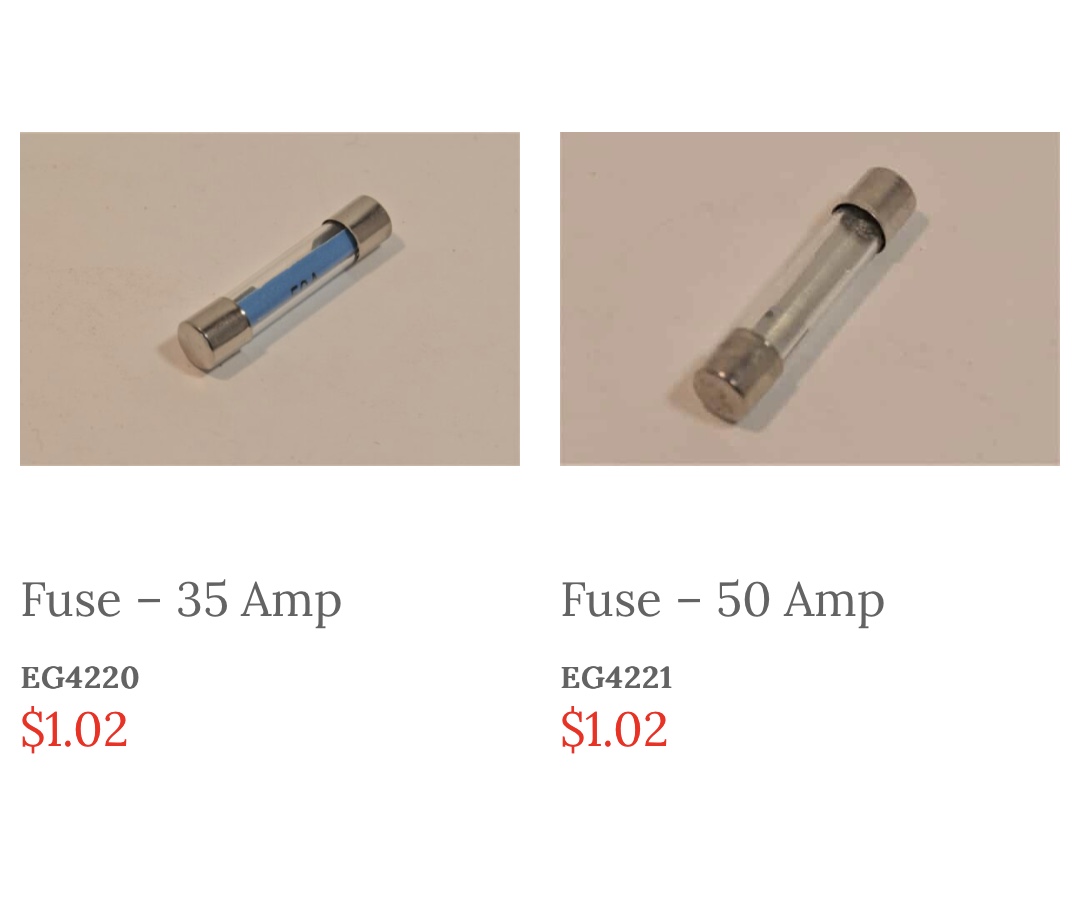

One is 50 amp one is 35 amp I think . Check your manual in the electrical section it should tell you .
If you don’t have a manual you really need one to own and keep these old cars running .
