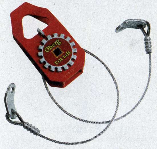

Don't forget:
1) You can jack-up the rear of the car for additional maneuvering options
2) An Oberg tilting lift is a huge plus
attachment.php

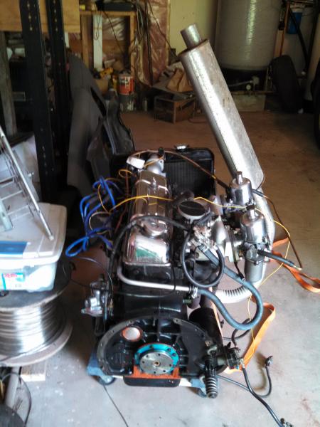

I ran my motor on the floor so I could fix leaks while I had the chance. It paid off when I discovered a small seep between the plate and the block. I had used gasket cement and the plate was bent a bit. Using Permatex and really glopping it on fixed the problem.
By the way the picture doesn't show the flywheel. I was checking on rear seal leak after running. Happily there was none. The Alexander rear seal really worked well. Homemade muffler made from scraps since my wife complained about the noise.
