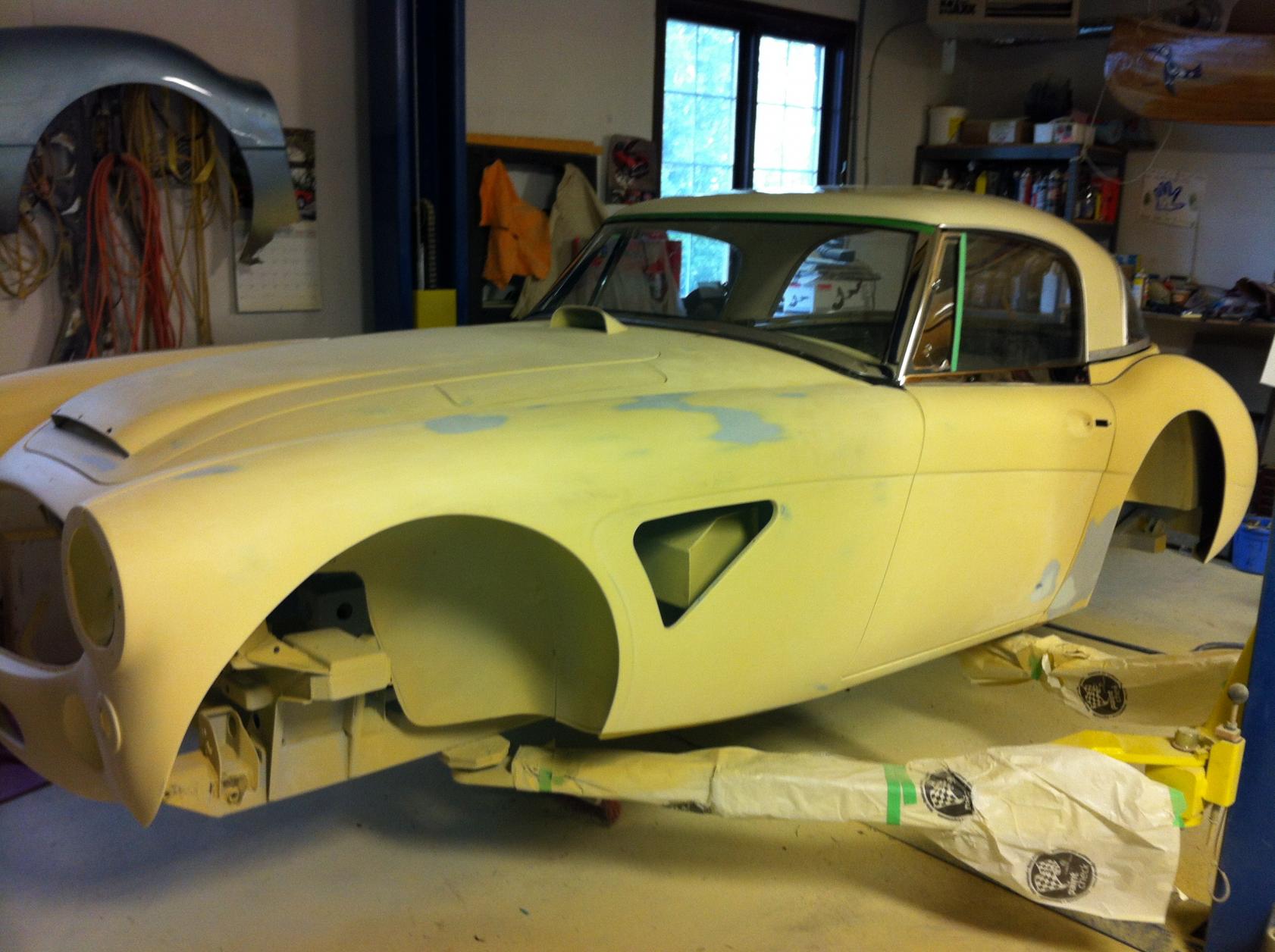

I'm seeking a pneumatic or hydraulic car lift for my '63 Austin-Healey BJ7. Preferably, one with a track that will accommodate the Healey's narrow track of 49"-50" and that will have a drip pan underneath the entire length of the car to catch all the oil that drips down so as to protect my daily driver to be parked underneath. Anyone have one they love and can recommend?

I went with the HD9 and my BJ7 fits fine. I can also use it to lift my F150 for service. My ceiling is exactly 10' And the car goes to the top with the top down. Bend Pak meets all industry safety standards. I would also recommend a jack shaft garage door opener (about $350), alluminum ramp option, bridge beam for jacking, two plastic drip pans( lighter) and Dolley wheel set. I decided the wider HD 9 a better choice for future sale and flexibility with minimum price and space difference. One of the ramps on the HD9 can be mounted in two positions.
