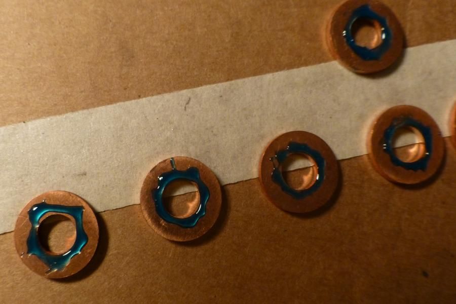

I also used Hylomar under the copper washers (do not know if yours has Cu washers):
