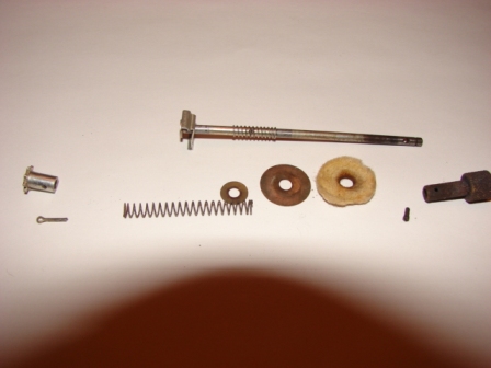

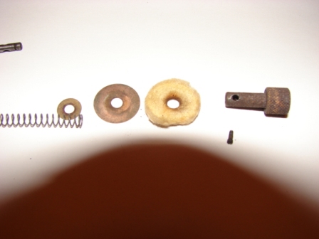

Curious as to why you cut the rod. The knob just pulls off after you remove the setscrew. The cotter pin only holds the gear to the shaft. The shaft is one piece, not two.
I recently had to buy an entire junk speedo on eBay just to get the rod. It was the only part that was any good!
I had two others here that had had the reset rod cut.
You <u>could</u> make a thin wall sleeve and join the two pieces back together.

MXP, I just went and did a bit of playing around with one, trying to come up with a game plan.
To do it properly, the reset knob <u>has</u> to come off, as it's a larger diameter than the hole in the case.
The <span style="color: #FF0000">only</span> "lower part" of the rod is the knob. The rod is one solid piece, as shown in the above pictures.
You <u>will</u> have to pull the needle and gauge face, though. That's no big deal.
Reassembly is pretty straightforward. After the rod is in place, with the gear pinned to the shaft, just install the speedo hub. Reinstall the knob, gauge face, needle, retainer cup, glass and trim ring.
I hope this helps. If you need more help, I'll take one back apart, taking step by step photos.
