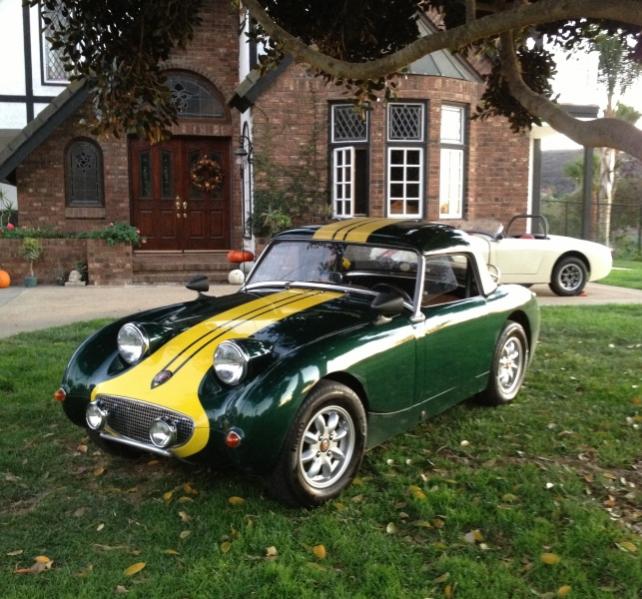

Think I found one - but this time no pictures, as it might be recognized.....well, maybe one....... owner asking $11K....well known enthusiast in the bugeye world.
Re: Looking at Bugeye - any advise?
This is a nice driver with many custom features in good taste. Soon to have a pre-purchase inspection done.
