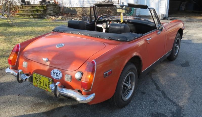

I'm looking at a '74 Midget here in Maine to replace my '80 TR-7. I've owned a Midget before [a '72 from 1979 - 1985] and have decided that it's time to return to the fold.
The owner has been quite upfront about its defects but it's been under the care of a well-known shop in Maine and I can get a professional assessment from the mechanic/shop owner. Structurally it avoids the worst of the Midget's monocoque rust issues while still having its share. Cosmetically it's "fair" although it's had suspension, engine maintenance (1275 "original engine"], ignition upgrades and brake caliper work in recent years. It now has 77,000 known miles; the current owner put on 1800 this past summer.
It has a second gear "crunch" when downshifting into second but it does not pop out of any gear. The gas gauge doesn't work [if it's not the ground is it easy to replace the sending unit?
Any advice for the unwary on this particular year's Midget?

Rust, rust, and more rust. Midgets and Sprites are stout little cars, but rust is their bugaboo. Check the A-pillars, floors, sills, spring hangers. If the bodywork is solid, all else is pretty easy to manage.
Transmissions can be had fairly cheaply if you need to replace or rebuild due to that syncro going on second, but keep in mind that you have to pull the engine to get the transmission out (no other way). Also, make sure you fit. :grin:
That said, they're great little cars.
From the description, sounds like a good car just to drive and enjoy and fix any issues as they arise. One of the hardest things to do is to resist the urge to try to fix everything and before you know it you're on the road to a full restoration and missing out on a lot of lovely summer evening drives around Mid-Coast Maine.
If you decide you can't stand that transmission graunch, these guys will sell you a rebuilt for about $1000 and have an excellent reputation: https://www.quantumechanics.com/qm-htm/sprite1.htm Throw in a new clutch, pressure plate and pilot bearing while you're at it. Could do the job in a long weekend.

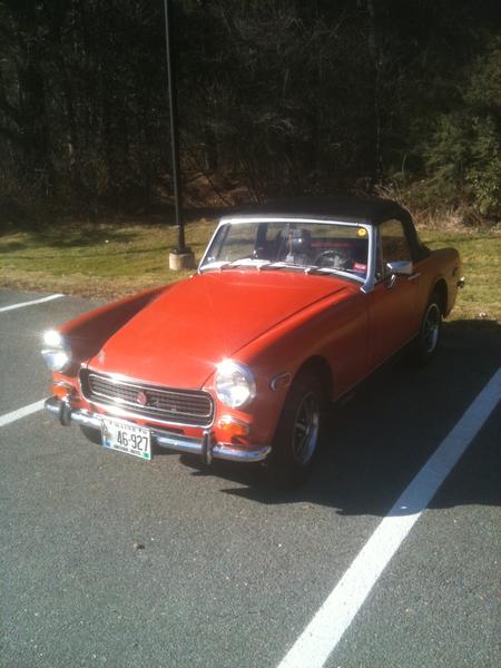

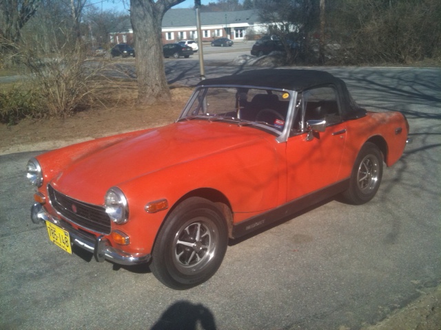

A telephone conversation with the mechanic who has worked on the Midget, John Campbell of Sport Cars, Harrison, ME, was helpful in reviewing the work he'd completed on the car, and also in assessing its structural condition. Fortunately, it's in rather good shape, not cosmetically but structurally. I've arranged with the owner to see the car next week. As always thanks for your guidance.

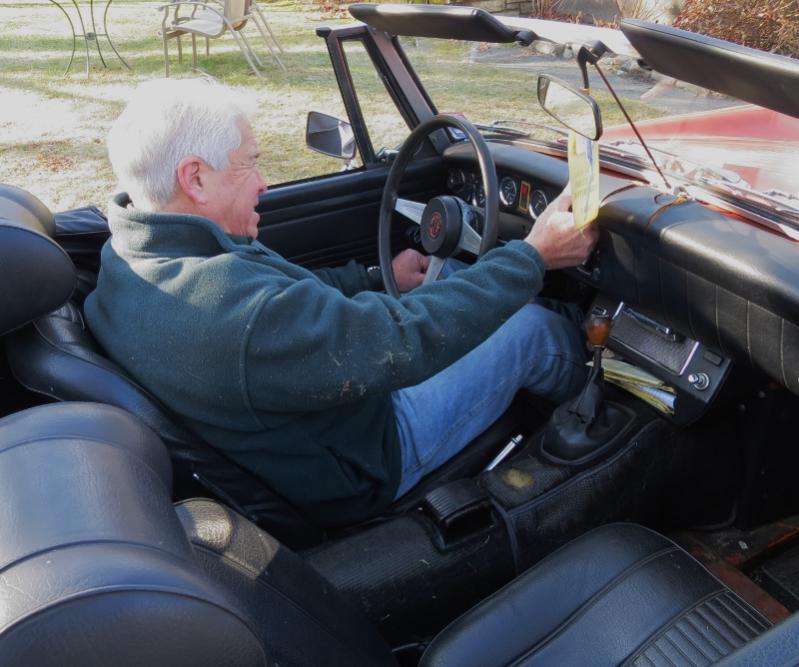

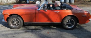

I took nearly two hours this morning looking at this '74 Midget with 77,000 miles. With the top down and no heater [removed from the car] it proved a brisk test drive in 40 degree temperatures but I found it pulled strongly, shifted with just a touch of clash into second gear, maintained high and steady oil pressure relative to rpm, went up to normal temperature and stayed there during the drive.
Most importantly, I took a body shop/mechanic friend along for an objective opinion on the structural condition of the car. The current owner was quite right in his assessment; it's in great shape for a New England car. The only rust we could find, even from underneath the car, was a hole in the left side front inner fender well.
I'm seriously considering purchasing this one. The current owner wants to sell so he can buy a '68 Javelin - to each his own :smile:.
