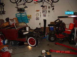

woo hoo! Look what bit my hook!

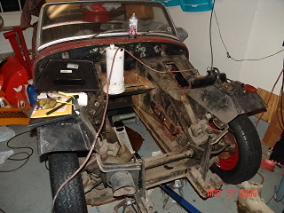

I borrowed a hoist and engine stand from another MG buddy and got my engine out last night. I plan on getting the engine out in the yard and degrease and powerwash it. I plan on doing the same thing with the engine bay. I have been making slow progress, getting many little things done, like rebuilding the calipers, rear brakes and other stuff.
Right now, I'm thinking about chemically stripping the body then blasting the rusted areas for repair.

Looks good John...progess, progress, progress!
Progress is a wonderful think, way to go.
Oh boy. Way to go zimmy.
Zimmy, that's great news.
And yes, a little progress definitely keeps one motivated.
