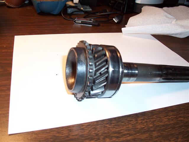

Look at this part.
jlaird
Looks like oil has burnt on this over the years. The balk ring actually is suppose to ride here.
Left end ring, black smooth except where it came off and is proper underneath.
Anyone seen this before?
Not sure I think that is a coating. I think it is more likely something burnt on there. Maybe. None of the other parts have a coating but then what I know about trannys is next to nothing.
Yes, there is supposed to be a bronze sleeve sintered on the conical part. I've got a ribcase that DPO ran out of oil that have all of the sycro's looking like that.
Kurt.
Got lots of input gears that look like that. Same for 2nds & 3rds. Probably needs replacement. But, the dog teeth (little ones) don't look beat up enough to suggest a completely worn out gear or syncro. I've known a few people who have tried to repair the gears that had lost the sintered material, but very few have been successful or lasted doing it. Replacement inputs (new) are very hard to find. Good used ones are readily available.
Mike Miller
Ahh, I am learning learning learning. Thanks.
This tranny will never be raced or even driven hard by me so used parts are great as long as they allow for smooth shifting.
Thank goodness my Lay gear is absolutely pristine. In fact I am not sure that it is not new.
The layshaft gears may not be worn but the I.D. where the needle bearings live can. How does the shaft look?
No clue Doc. will check later, they are still wrapped and packed.
