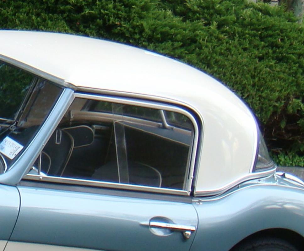

Andy, I think the screen has been modified but not sure that is the whole problem. He is a photo of my sidescreen and hardtop.

Thanks guys, that's kind of the answer I didn't want because it's going to be the hardest one to remedy. Probably going to go with the simplest option which will be to pack out the hardtop weatherstrip so it comes into contact with the sidescreen.
Derek- Thanks for the pic. Your sidescreens look like the later style which seem to fit better around the top. I had a look at some on a Tricarb on the weekend and they are quite different to the Longbridge ones which do have a curved top profile according to the pics on your website.

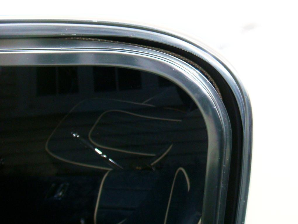

Hi Derek,
I have also put new felts in and the forward panes are now so stiff I can't move them by holding onto the block handles. These panes are DIY jobbies from many years ago and I have ordered some new ones from UK which I'll fit shortly. Hopefully the replacement ones are slightly thinner and will slide more easily.
The vibration comes from the two panes clattering together in the middle from wind buffeting. It only happens over about 60mph and by the look of the wear marks you can see in the pic below I'd guess they have been doing that for many years. I'm trying to think up a clever way of sealing the 1/4" gap between the panes that won't look ugly. Those curved slider shower doors have a silicone moulding pressed onto the edge of the glass which performs a very similar task, maybe I can find something similar but for thinner glass/perspex. Andy.
