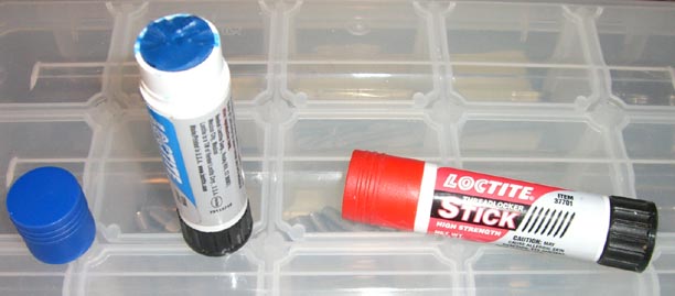

FYI for those who haven't seen it, Locktite comes in a handy stick form now. :thumbsup:
