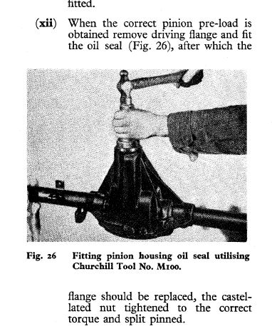

Have a bit of an oil leak at front of Lockheed diff on my 56 TR3, and before driving season starts was planning to replace oil seal at front of diff. Manual makes it sound very easy (assuming pre-load can be left as is). Is it really this simple or am I likely to encounter "hidden" issues? Anything special to look out for? Thanks, Mike
Nope, pretty much just as easy as it sounds. Only hard part is holding the flange from turning while you remove and install the nut. I drilled some holes in a piece of flat iron from Home Depot, and bolted it to the flange. (This isn't a TR3 obviously, but I used the same piece on the TR)
While the flange is off, clean up the sealing surface with fine abrasive cloth. If you can't polish away the mark where the seal rides, then consider installing a Speedi-sleeve or replacement flange. But, if it's the original seal that you are replacing, chances are that the replacement (which will be rubber instead of leather) will ride on a different area anyway.
Oh yeah, you need to be a little careful while prying out the old seal, not to gouge the housing.
