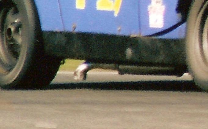

This (below) always worked for me at Lime Rock.
I use a steel tube stuck into the the rear jack hole to support it. Cheap Summit "sausage" muffler and slight turn-down. The whole thing can be removed in a few minutes (the ground clearance in this picture is deceiving...the front wheel is down in a hole)
I dislike the Super Trapp. They only seem to work if they almost fully corked up.
My 1500 never attracted any attention with the LR Noise Police.
Which is another point. Once you're out there, if you can figure out where they are (usually the right-hand uphill after No Name Straight) you can short-shift or back off when you're next to them (at least during practice).
Sorry for the poor photo quality. Since sound level is so dependent on direction I put a 90' turn down on mine and point it straight into the pavement.

Lime Rock was always a bit hard on my low exhaust because it was so bumpy, but they're re-paved it, so you should have no problem with clearance.
Although the 1500 may sound loud in your front yard, in reality, it isn't nearly as loud as many other cars.
I've stood in the pits and heard my unmuffled car go by on the main straight at Summit at 6000 rpm. It sounded quiet compared to almost all the other cars. The V8s and rotary Mazdas are the real noise makers. I bet you'll be fine.
I ran my HP/FP Spridget with a thru-tunnel exhaust, no muffler, with it turned down just in front of the rear axle. It was always one of the quietest cars on the track. Nice thing with the thru-tunnel is off track excursions don't tear it apart. :smile:
