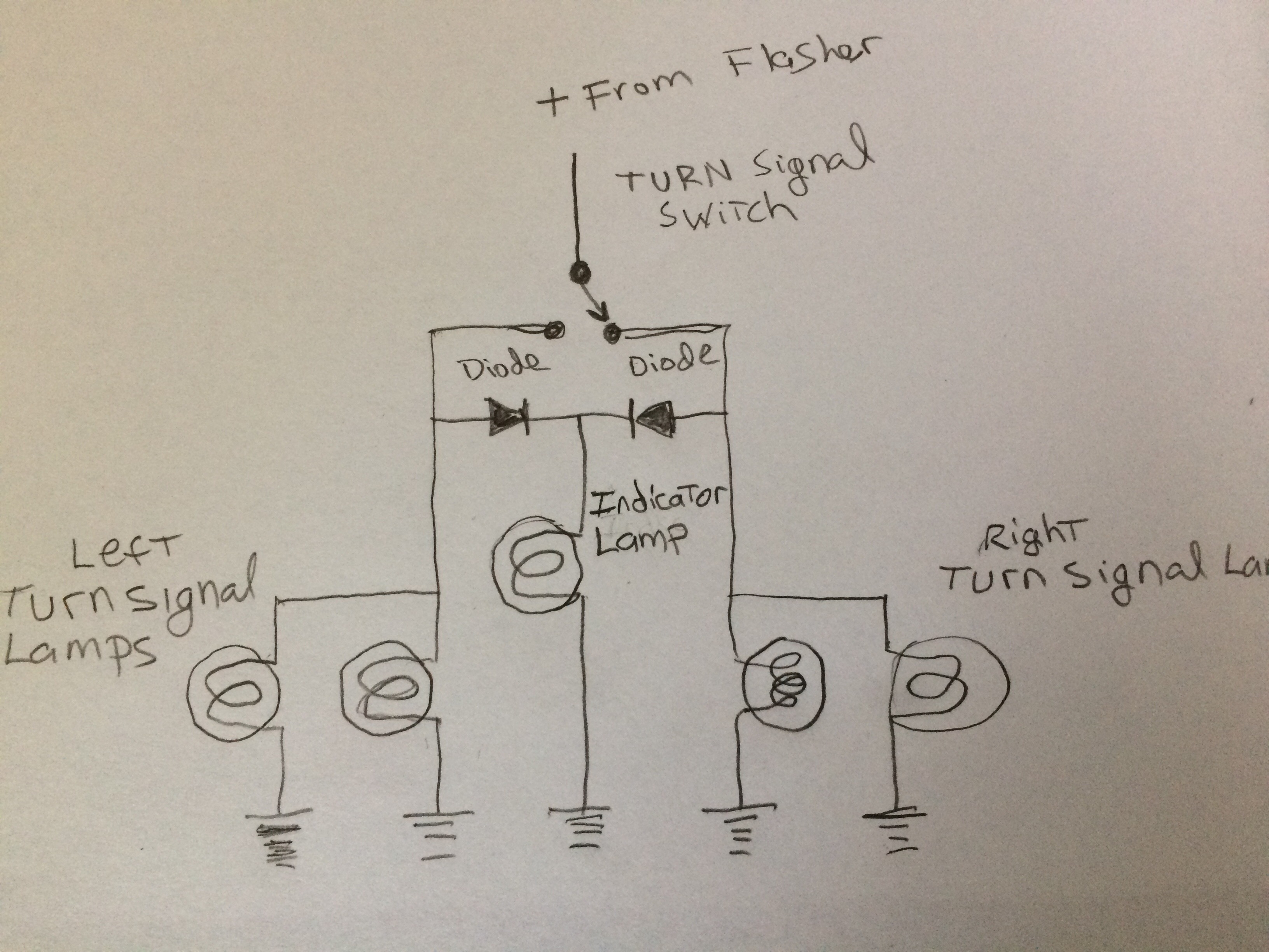

When I made the change to LED's I used two diodes for the turn indicator LED bulb. I'm guessing that the diodes will keep the errant voltage from getting past.
The turn-signal indicator is pretty simple, just a wire from a special terminal on the flasher to the LED lamp. My best guess is that (1) the flasher and lamp are not compatible in some way, or (2) the flasher is defective. Beyond that, standard advice: make sure that the connections and grounds are good.
If all else fails, Elliot's suggestion, above, should work well.
