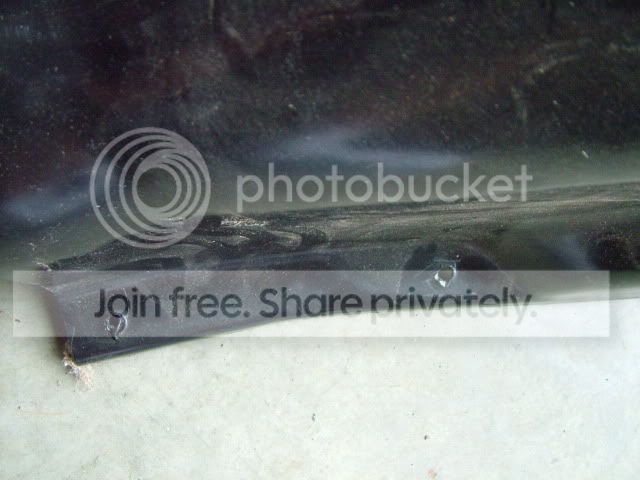

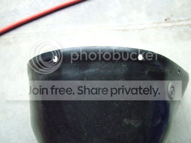

Hi guys - so I installed the poly gearbox cover on the '74 TR6 today, and man what a total pain. So in case anyone is about to do this I thought I'd pass along what I learned. I'm sure there are other, probably better ways to do this, so please just take this as some ideas not anything definitive.
I drilled holes in the cover based on measurements and do test fitting, next time I won’t drill ahead of time since the cover flexes and instead drill based on installed fit hole by hole. I'd suggest start with the rear most section and then move forward from there.
I used ÂĽ inch longer bolts than the bolts provided in the kit. It makes it easier to get the threads started on a couple of the holes, or at least did for me.

There's no easy way to do it. The key was to drill a bigger hole to allow for error. I used a 3/8" or 1/2" drill.

My engine & tranny were out of the car so I was able to test mount the poly cover and "precisely" drill the holes for the firewall screws. That made getting those screws in much easier. The easiest way to install the cover is to drill all the holes in the cover out to 1/2" and then screw the tunnel bolts up from the bottom of the car so that the threaded end is sticking up into the interior. Now it's just a matter of wrestling the cover over the bolt ends and securing it with washers and nuts.
