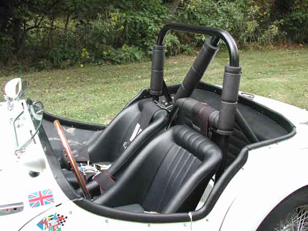

I think the Cobra or Corbeau Classics have that vintage look. I had to modify the transmission tunnel of my TR3 so they would fit, but a TR4A is wider. They are discussing putting these in a TR6 on the Triumph Forum.
Also they are light.
See attachment:

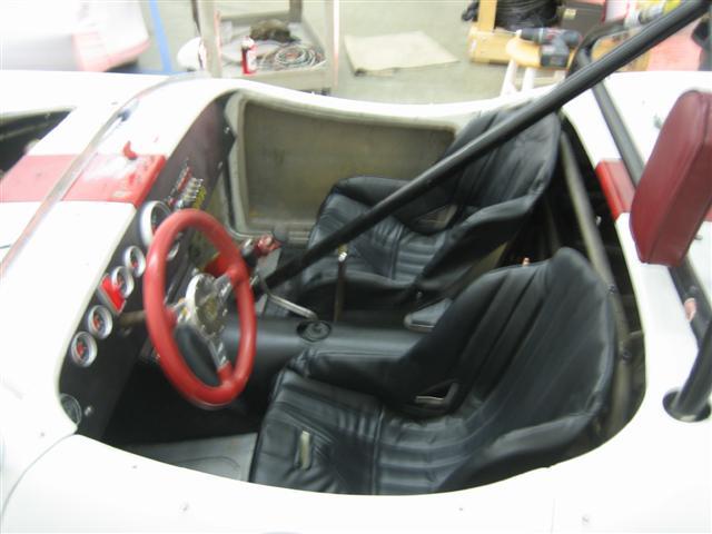

I recently replaced the original seats in my Elva Courier race car with a pair of Kirkey Engineering "Vintage" model aluminum seats. They are reasonably priced (about $400 with sculptured rolled and pleated cushions)and look appropriate to the car. The old seats were very lacking on support even with a five-point harness and I'm sure these will be a vast improvement. BTW I will be racing with them for the first time next weekend at VDCA's event at Kershaw, SC.
See attached shot of the new seats.

That's the seat I have in my racer. It was like around $60 (from Summit) with the cover...but that was a while ago.
That seat is plastic and some organizations wll not allow it. I *think* my club will outlaw them soon.
I really like the "vintage" seats in Michael's Elva. They look like they'd provide a lot of upper body control (needed in small bore cars, as we pass the big tanks in the corners /bcforum/images/%%GRAEMLIN_URL%%/laugh.gif )
When I'm ready, I'll probably buy the Kirkey aluminum, economy race seat in Summit (around $100 without the cover).
