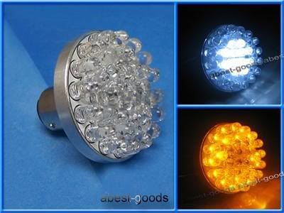

I'm also playing around with some LED white/amber front units like these
I picked up some "store bought" L.E.D. dual circuit bulbs a few years back, and did nothing other than remove the glass lens and chrome ring to install them.
Still using the original brake relay (newer replacement, but still the incandescent style) and signal flasher.
These are certainly brighter than the incandescent bulbs, but are not the large array as shown above.
