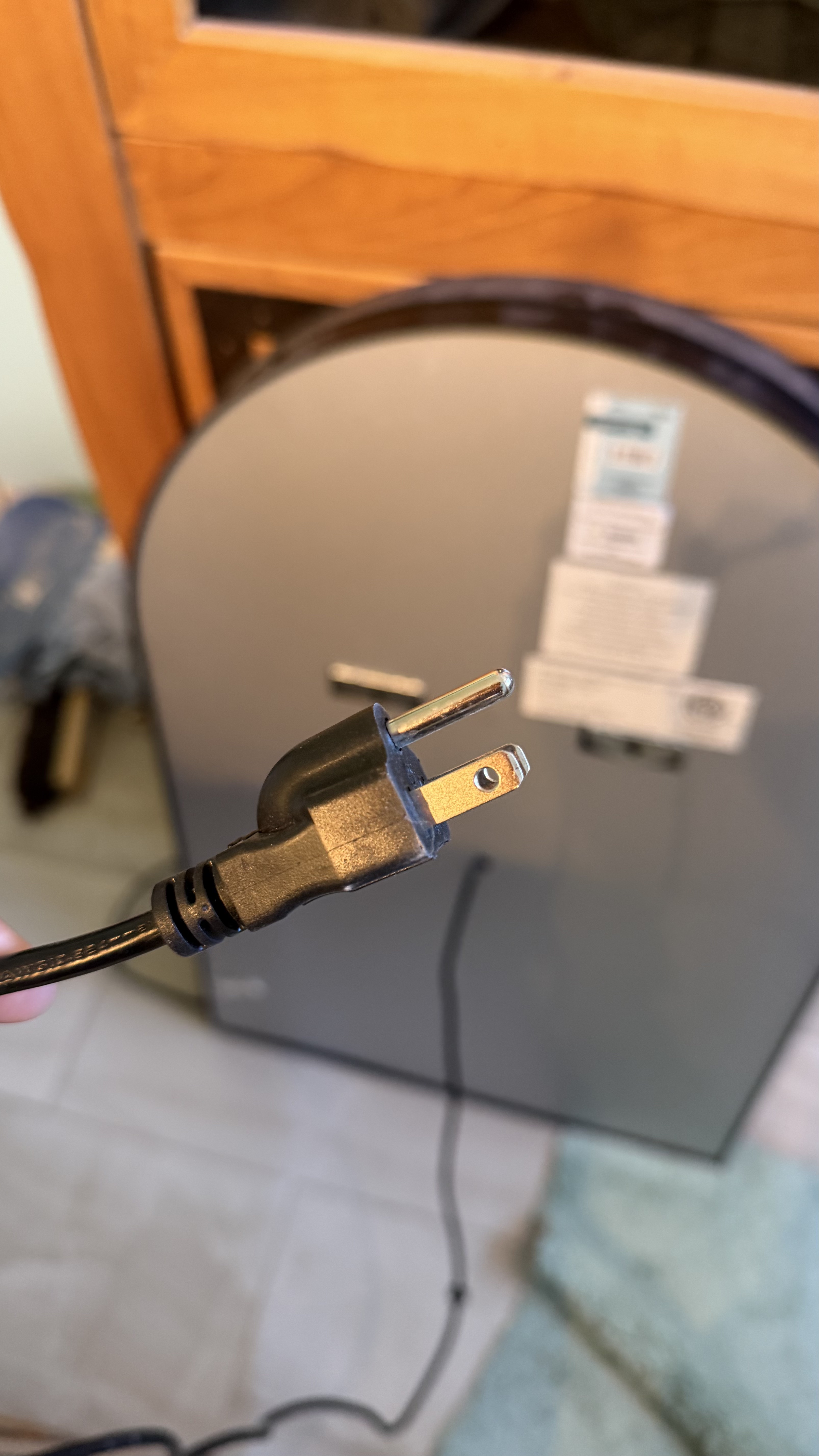

I might experiment with one of th mirrors and see if I can pry off the back without damaging it, then glue it back in place after the new cord is installed.
Forget about being nice. You'll wind up in the same place but a lot quicker. Gluing the back on only hides what will never be seen.

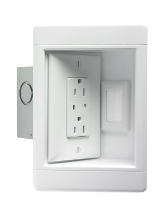

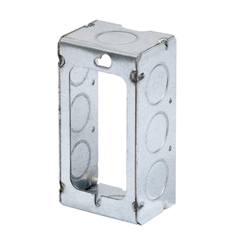

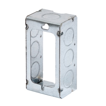

Have your electrician look into a box extender. If the stud depth will allow your box to be moved back, see if he can do that and then extend the box out to the face of the drywall and mount a standard receptacle to the inner box if possible, ditching the fancy all in one face plate that no one will ever see.
Or … just call the electrician in and have him figure out a solution for you. That’s why he’s getting the big bucks.
