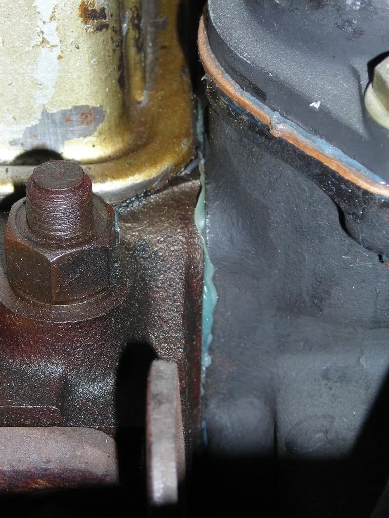

So the 'new' TR6 is leaking pretty badly from where the water pump mates to the block.
It looks like the PO didn't use a regular gasket but instead smeared some sort of gasket maker / sealer on instead.
So short of pulling the pump, any ways to fix?

Well I'm glad (as usual) that I posted this.
The picture I took is mainly of the housing, which appears to be dry all the way around. I think I got suckered-in by the way the sealer was applied.
The actual moisture appears to be coming from directly under the front bottom of pump behind the pulley. I can't really see the exact spot, but it looks like it has been leaking for some time judging from the front engine plate.
That would seem to be the weep hole, then, which suggests the pump is toast. Yes?
Yes.
