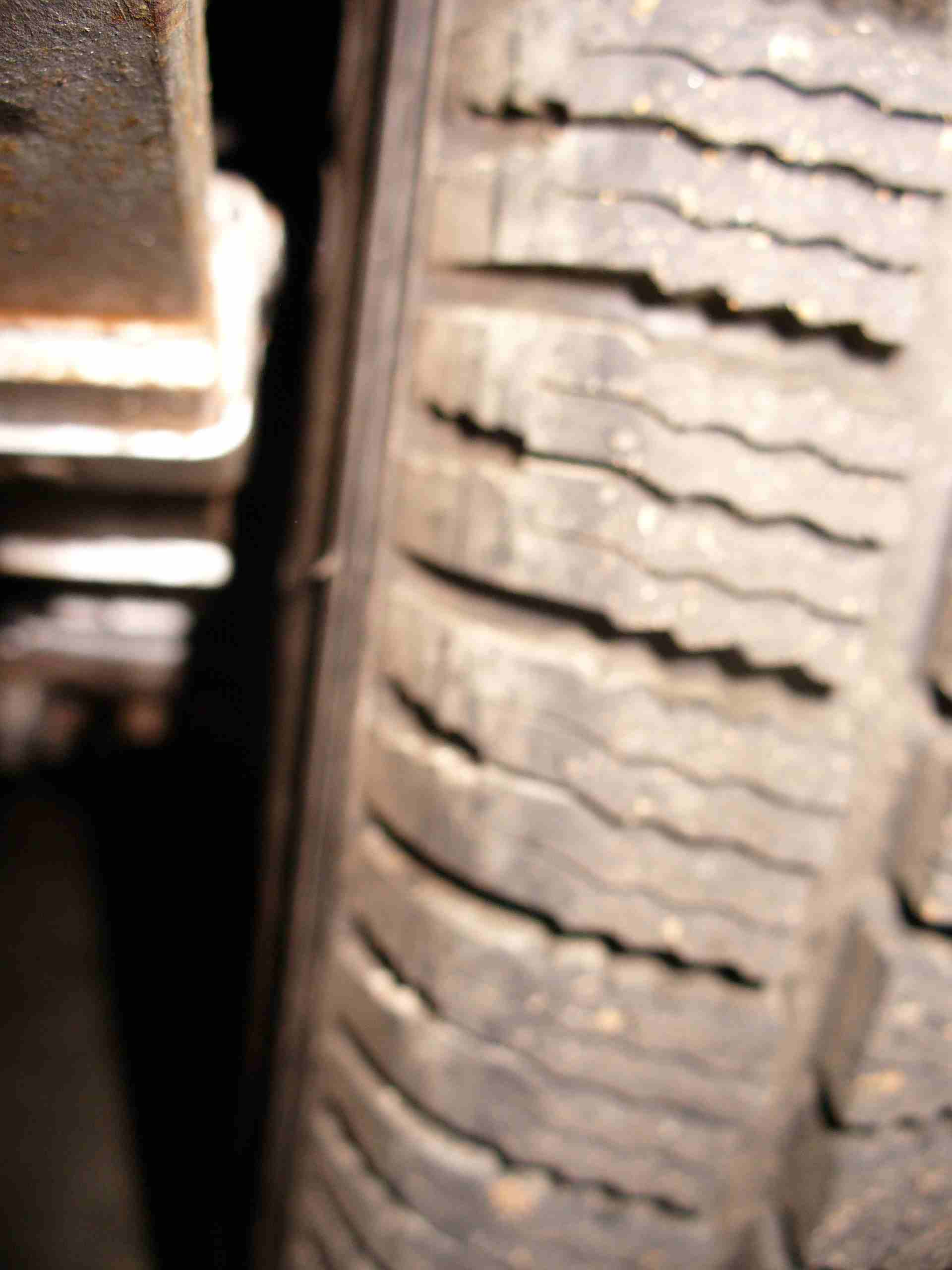

My right rear leaf spring on my 73 Midget sometimes rub against my tire. The clearance on both tire are less than a quarter inch. Any clue why? Could it be the springs are just too old? I do not think they were ever replaced. I replaced all the bushings to no avail. The wheels are stock and the tires are standard 145s X 13. I should not admit this but as temp cure I added washers to the lug nuts between the wheel and the brake drums. This can’t be a good idea. Any help to fix would be appreciated.

Thanks for getting back to me. Ok, I measure 41 inches from inside of wheel drum to inside to weel drum. I will try to attach a couple pictures of (i) left shackle (I could not get a good picture of right shackle becasue of exaust), (ii) right tire and leaf to show approximat gap, and (iii) right tire rub marks ( the inner ring).

Purple Midget, I just measured two of mine, and I've got 42" drum to drum. On the '72, I've got 175-70's on 5" wide wheels, and the closest I come to a spring is 3/8" at the rear side of the tire, next to a spring clamp. Never had any problem with tire rub.

Went out for another look see and its looks like my right leaf is not parallel to the tire. The right tire gap forward of the axle has about a ¾ gap between the leaf blade and the tire while the gap to the rear of the axle has about a ¼ gap. The leaf spring clamp reduces the gap which leads to rubbing against the tire (turns). The left tire gap is about ½ inch for both the forward portion and the rear portion.
