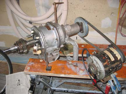

I agree with Marv about the 1/2 inch drill. I used a heavy rubber hose for a connection. I slit the hose on the one end in four places slid it on to the tranny shaft clamped it down with a hose clamp also clamped it on the drill.
I have pictures but am having trouble getting them into the forum post. If you are interested I can post them to you. Send me a personal message with your email.
Cheers, Dick

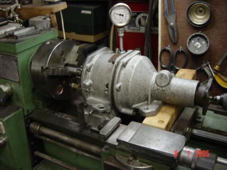

We checked the output pressure (325 psi) of an "A" type overdrive for a TR3A on my neighbour's lathe. It had enough power to drive it. Some electric drills will work but many are not powerful enough,
IMO what you want is a 1/2" drill motor that turns at the lower speed (like 850 rpm). One of those 3/8 things with a (top) speed over 1000 rpm hasn't a hope. My old Milwaukee has no trouble turning the gearbox & OD, although you can hear the speed drop just a bit when the OD kicks in.
