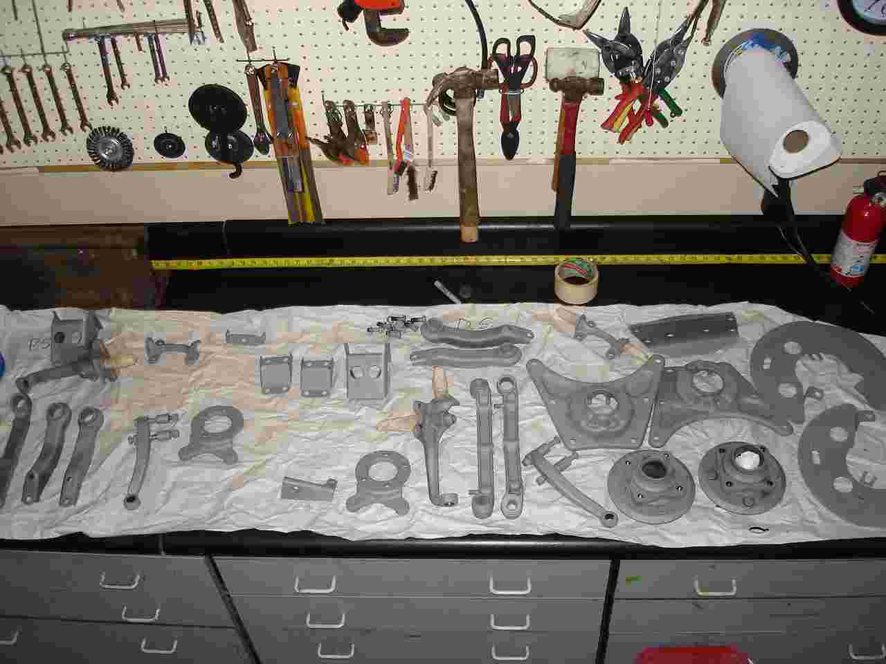

I am finally putting parts back onto the frame!!! I can't remember if I am supposed to ream the lower, outer wishbone bushings or not. I have pressed them into the wishbone and now the assembly does not want to go on to the new trunnion cross shaft. I called TRF and they said that it should be a close fit, use a mallet. I seem to remember reaming these last time???
Is there a reamer out there for this application that you have used that worked well? The local auto parts store had a 2 stone reamer that only adjusts down to 11/16", used for hydraulic bores. I can't find those ball reamers I use to use.
Thanks,
Greg

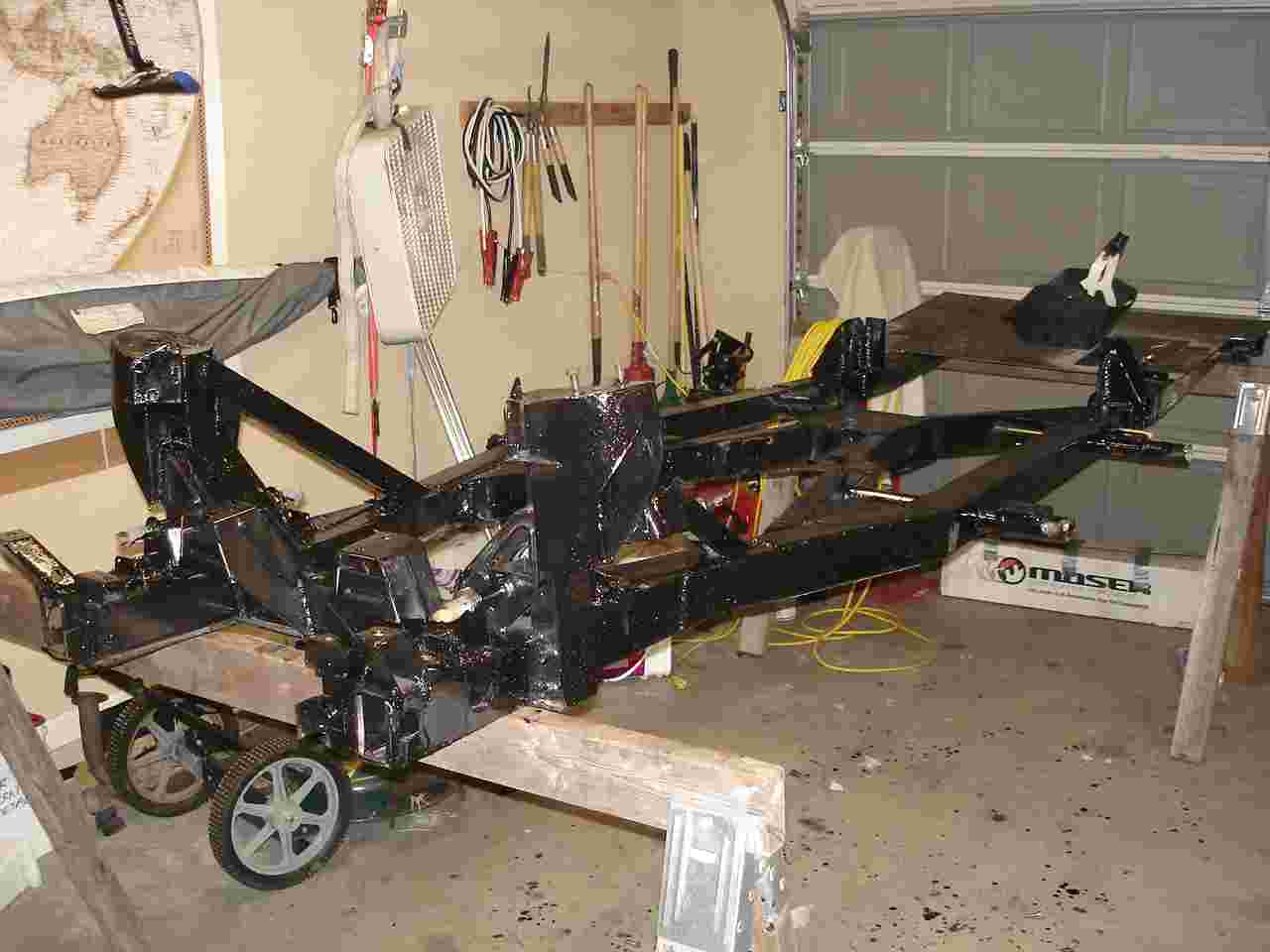

Picture of front end. I wish I could remember where all those parts go.
