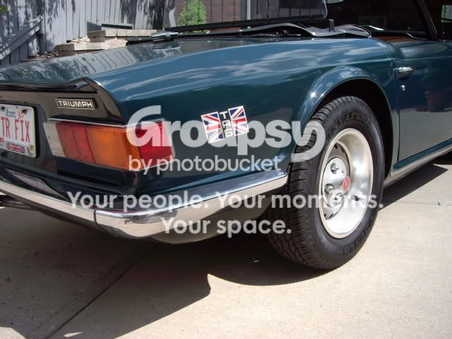

Just installed Dunlop Signatures 205/70R/15's this week, I think they fill the well properly.

Nice, Graham. From what I see your car is some FINE.
My Dunlops had mould release that took over 50 miles to wear off. Got kinda slippery there a time or two. Since then, they haven't broken once.
