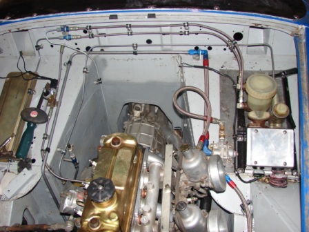

Not a lot of bling here. The carbs <u>came</u> with the #4 AN fittings in them, and I had the hose and fittings on the shelf.

Is that a pocket fisherman on the left side (pass side) of the engine? /bcforum/images/%%GRAEMLIN_URL%%/devilgrin.gif

No, Pat, it's a short pry bar with a tranny dust plug laying on it. I was in the middle of working on the thing when I took the picture, and didn't bother to do a tool sweep.

I was just bustin ya, at a quick glance that is what came to mind. Sick Friday afternoon at work.

OK, fuuny story here, back in the early mid 80s when I owned and raced a Huffaker MGB, At the Daytona SCCA national we forgot to burp the radiator and the car got hot enough to alarm me, and I shut if of just before the back straight chicane, the worker waved like mad for me to get out of the car and go up the bank where the lake is at Daytona Speedway, so that's where I sat until the session was over, on the banks of the lake there. Went back to Daytona a few years later, and my crew chief at the time, told me he wanted to show me something he had installed in the trunk for that event , he had zip tied a Popeet pocket fisherman in the trunk, he said if you get stuck over there again, bring us back some fish /bcforum/images/%%GRAEMLIN_URL%%/smile.gif
