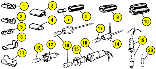

And now the question: where can one buy Lucas connectors? The piece I need is one of those rubber covered double-ended double-barreled sockets, that can connect two wires at one end with two wires at the other?

Julian, Moss carries the bullet connectors. Index 9 on this view. P/N 161-600, 0.95 each.
I buy mine from British Wiring.
https://www.britishwiring.com
Or,if you want, PM me your address, and I'll drop a couple in the post.
Jeff

Julian is not installing any bullet ends on the wires. All he needed was the four socket female bullet connector to connect three wires.
I mailed him some this morning.
