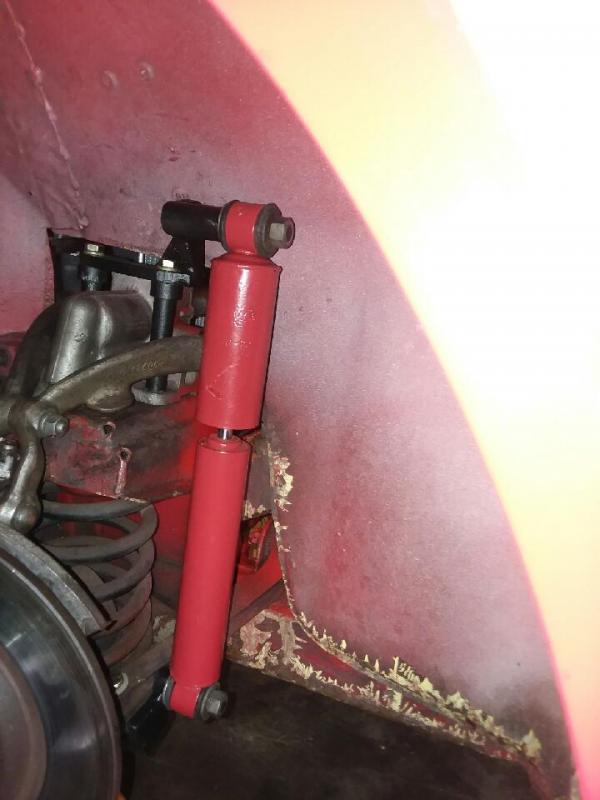

I finally have the drivers side in place. I believe that it is correct. after replacing the front wire wheel hubs with disc sheel hubs I still have a bit to do. ...new brake lines, shims for the bearings, steel line to the flex line bracket was missing, make new pipes flexline to the calipher. etc. every time I look to correct something a new can of worms develop. well most of it is stuff that I would replace or rebuild anyway! part of the "learning curve of enjoyment" and at almost 79 something to keep me active!!!

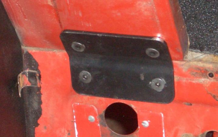

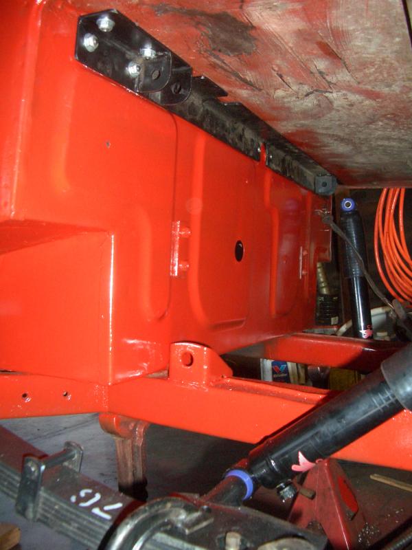

That Koni kit looks very similar to what was fitted to the cars built from kits in South Africa. There is a guy in British Columbia that has a CKD South African built car. He was parked next to me in 2017 and showed that setup to me.
So the rear Koni conversion is for the 2 + 2 seat configuration.
It should work on the 2 seaters, too. Mine is a Cape setup, which is similar. I had to bend the angled plates a little because the angle of the transom is slightly different on the 2 seater. The right-angled box area above and behind the axle is the same on both. The supplied shocks were perhaps 1/2" too short for the 2 seater setup and the lower mounts flexed and eventually broke. Make sure your shocks are long enough when extended to accommodate the lower axle when it is resting on the frame cushions.

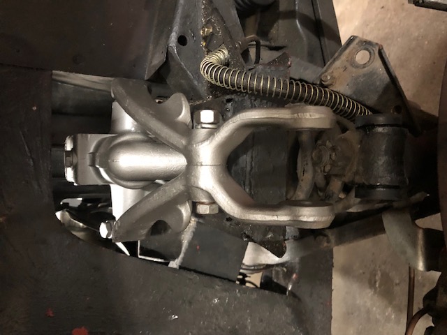

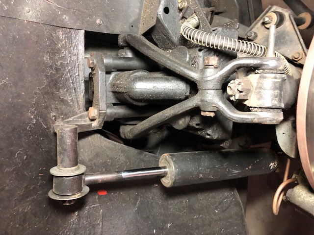

I believe I have the same Koni conversion. I removed mine from my 100 and installed new lever shocks. I want to see if I like the feel without them. I’m going to drive the car for a few weeks and make a decision.
Let us know how your test goes.
