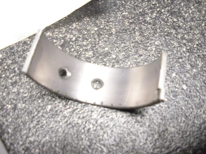

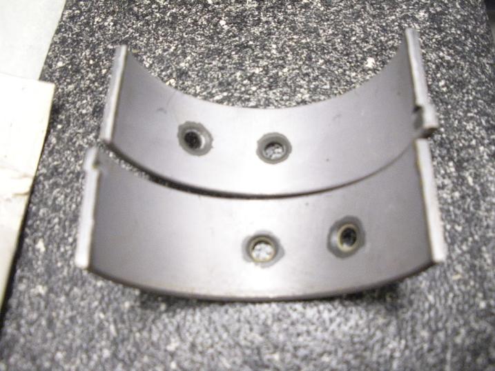

Warning: for you all out there trying to source NOS Vandervell tri metal bearing, often times thess bearings have not been made for a couple of decades at minimum, and command a premium price, be VERY AWARE, that many of these old Vandervell tri metal bearing are shelf aged out, and the top lead shell has started to discolor, delaminate, rendering them uselss, if you see discoration and flaking on the face of a NOS Vandervell tri metal bearings, I would highly advise you to not to use them in your engine. Be very aware these bearings are often offered on Ebay and by some NOS offering vendors, if you see this, know these bearing showing these conditions, they cannot be trusted.

Well as you know Peter, not all NOS Vandervell bearings are trash, and I think I did a fairly good job of alerting people what to look for. After buying several sets of NOS Vandervell bearings from a vendor, and paying a premium price for them and not being able to use them, needless to say I will not use that vendor ever again. I recently bought three sets of Vandervell VP2 bearing out of Ebay UK, two were good, one was junk, I could only wish my odds with other vendor were as good. Peter, I'm sure you know this problem exist and being the good vendors you are, would not sell the above described bearingd to anyone.
Here's a couple of example of some NOS Vandervell that are IMHO, not usealbe, you can see the separation of the top layer at the oil holes, and even copper showing in one, and one bearing where the top layer was missing on the edges and and in all cases you could feel with your fingertip, I don't consider a discoloration you cannot feel with your finger a issue.
